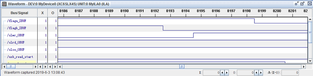

  I used cyusb314 in slavefifo mode with 16bits bus, and there are two bulk endpoints(0x81 0x01) in it. the dma buffer size corresponding each endpoint is 16*1024 bytes, and the counter of each dma buffer is 2, the pclk is internal(96MHz).  The fpga drive the slavefifo bus in negedge pclk. There ar some srange problems about the slavefifo mode.
       (1) While I transfer data from fpga to cyusb3014(in diection), the slwr should be last 8193 pclk cycles(in word), then the transfered data are right. If the slwr last 8192 pclk cycles, the data still be right(the counter of in dma buffer must be 2), but if i changed the the counter of in dma buffer like 4, the cyusb3014 will be disconnect when i transfer data from fpga to cyusb3014. you can see the sequence diagram in fig1 and fig2(the slwr last 8193 pclk cycles, and the 4 counter of in dma buffer is ok).

fig 1
fig 2

    Query 1 that i talk about is my fault, fig 1 and fig 2 are the transfer from FPGA to FX3, If the DMA buffer is 16384 bytes, the FPGA should send 8192 words to FX3, not 8193, but if i put the counter of DMA buffer into 4 or more, the usb chip will be disconnected itself, when the  transfer from FPGA to FX3  is done.(#define CY_FX_SLFIFO_DMA_BUF_COUNT_P_2_U      (4)//in)

Query 1:
The FX3 device must ideally not be disconnected when it receives additional data on the GPIF II interface. Instead it throws PIB errors. Can you please check the UART logs that is received before the device gets disconnected?
