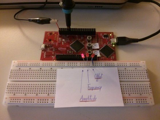

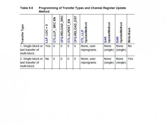

How to do a Multi-Block DMA Transfer with Linked List for Source and Contiguous Destination Address?
This example shall demonstrate how to do Multi block DMA transfer using linked list for source and contiguous destination address. The benefit of using linked list offer better flexibility to control the source and destination address during each DMA block transfer.
533.attach
574.attach
Please download the zip file which will guide you on this example.
The file "iLearn GPDMA_Linked_List.zip" contains the following
- Working project of the mentioned topic
- A readme power point slide describing the implementation.
