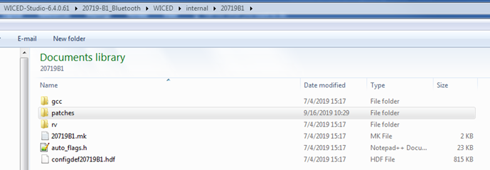

  3. After the installation is complete, replace the patch files in WICED-Studio-6.4.0.61\20719-B1_Bluetooth\WICED\internal\20719B1 with the new patches available with this KBA.
