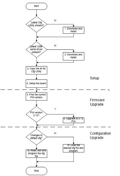

Answer: CYPD1120 can support both 4 lane Type-C to DP/mDP (pin assignment E) and Type-C to VGA/HDMI/DVI (pin assignment C). The default programming on the CYPD1120 supports both C and E pin assignments (C+E). Cypress provides firmware and configuration files for supporting pin assignments C, E and C+E. Cypress’s EZ-PD Configuration Utility can be used to program parts with the desired firmware and configuration settings. The entire process can be split to three main steps: Setup, Firmware upgrade and Configuration upgrade. The flow chart for the process is as shown in Figure 1. The detailed steps are explained below with the corresponding step number listed in the flowchart.
Fig 1: Flow Chart for Configuring Pin Assignment

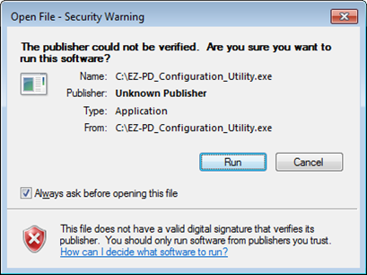

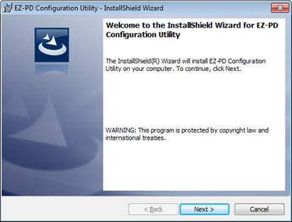

- Check if you have the latest version of EZ-PD Configuration Utility. If not, download and run EZ-PD_Configuration_Utility.exe. See the Utility User Manual for the system requirements.
a. Click Run.
b. Click Next

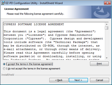

c. Select “I accept the terms in the license agreement” after reviewing the agreement. Click Next.

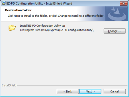

d. Select the install location (if not default) using Change and then click Next.

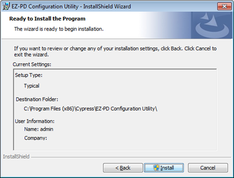

e. Click Install

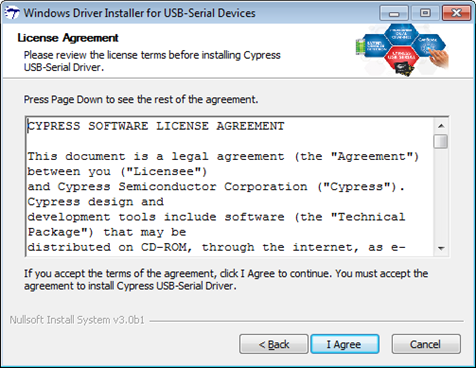

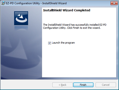

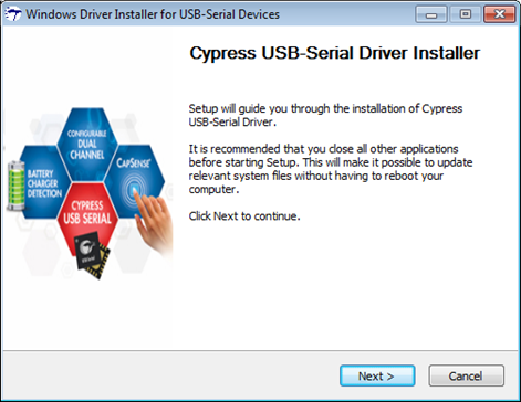

f. Click Finish - Download and install the Driver for USB-Serial. The EZ-PD Configuration Utility makes use of the USB-Serial device to access the Type-C device. Double click on CypressDriverInstaller.exe to start the installation.
a. Click Next to continue.
b. Click “I agree” after reviewing the license terms.

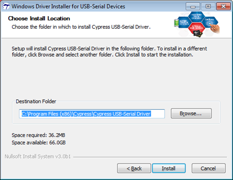

c. Click Install after selecting the destination folder.

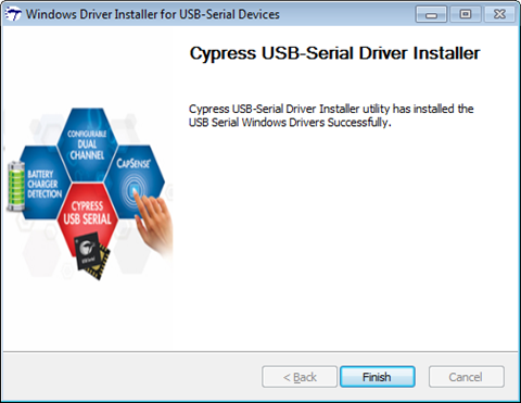

d. Click Finish to exit.

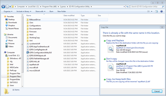

- Replace ezpdflash.dll in EZ-PD Configuration Utility. Copy ezpdflash.dll to C:\Program Files (x86)\Cypress\EZ-PD Configuration Utility. If you have installed the Utility in a custom location, you will find the dll file location at <custom path>/ Cypress\EZ-PD Configuration Utility. Ensure that the utility is not running when you do this step.

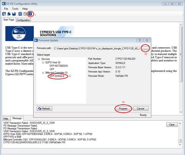

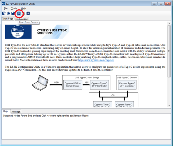

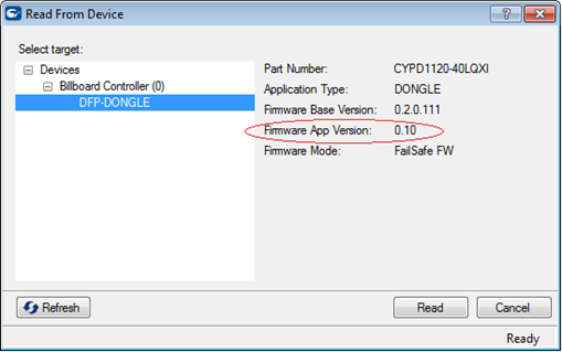

- Launch EZ-PD Configuration Utility from the Start menu. Determine the current firmware version using “Read from Device.”
a. Click on DFP-DONGLE to read the Firmware App version. The example below shows CYPD1120 firmware version 0.10. Please refer to the Firmware release notes to determine if you have the latest firmware and if you would need to upgrade. - Upgrading Firmware:

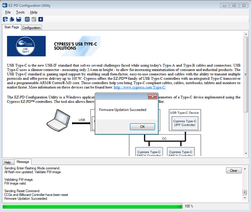

- If your firmware version is 0.10, it is strongly recommended that you upgrade to the latest firmware version. The revision note contains the list of changes with each firmware version. You can refer to the Readme.txt to identify the firmware file for your device package. If you wish to retain the 0.10 firmware, contact ccg_sw@cypress.com for firmware that needs to be used to support the pin configuration. Once you have identified the required firmware file (.cyacd), follow these steps.
- Select Firmware Update to open the update window.
- Select the device to be programmed.
- Select the Firmware location.
- Click Program.
- The following message appears after successful programming:

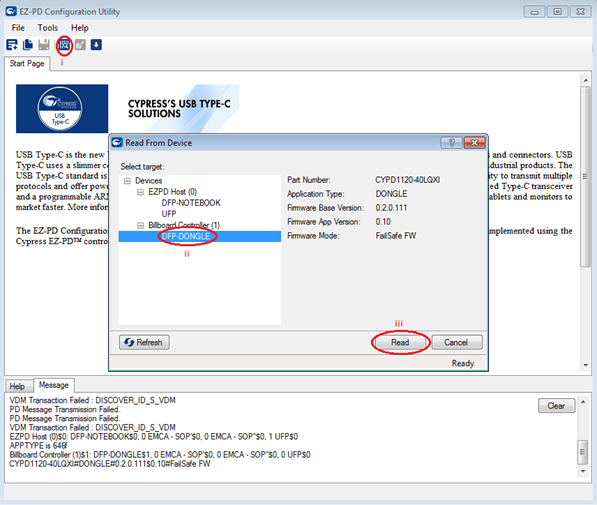

- Select Read from device.
- Select the device.
- Select Read.

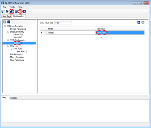

- Select SVID 0.
- Change the MODE 0 value. For pin assignment C, use 00000405. For pin assignment E, use 00001005. For pin assignment C+E, use 00001405.
- Save the changes.

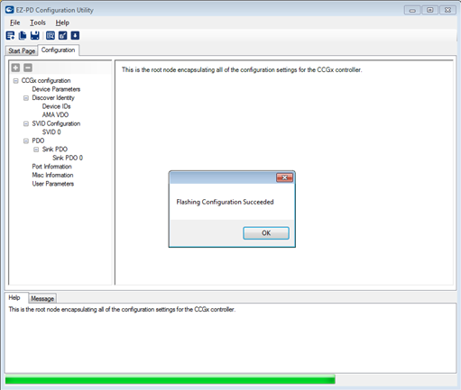

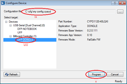

- After the file is saved, configure device would be highlighted. Click it to open the configure device window.
- Select the device to configure.
- The saved xml file will be already loaded.
- Click program.
- There will be a programming status message shown.
