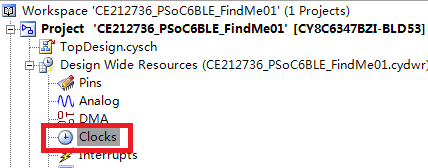

  1. Open a demo project. For example, open the ‘FindMe’ project.

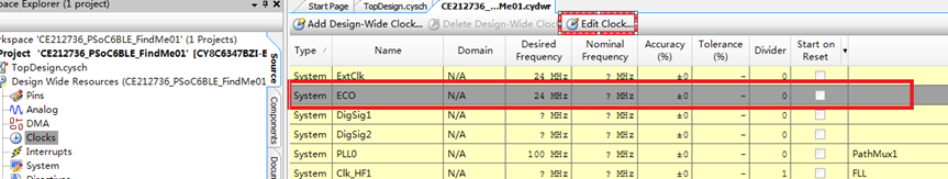

  2. Double-click Clocks, and then choose System ECO.
  3. Click Edit Clock.

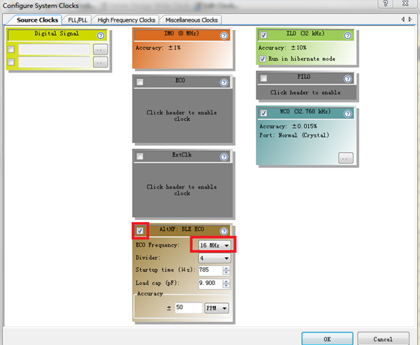

  4. In the Configure System Clocks window, enable the AltHF:BLE ECO option and chose the ECO Frequency as 16 MHz. Select the desired divider or use the default. The Startup time is specified in the ECO crystal’s datasheet. The Load cap can be used to tune the ECO’s frequency deviation. See AN95089 for details.

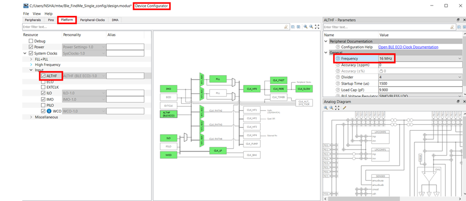

For ModusToolbox projects, perform the steps given below.
  2. Navigate to Device Configurator-> Platform and enable ALTHF option.
  3. In the ALTHF - Parameters window, choose the ECO Frequency as 16 MHz. Select the desired divider or use the default. The Startup time is specified in the ECO crystal’s datasheet. The Load cap can be used to tune the ECO’s frequency deviation. See AN95089 for details.
