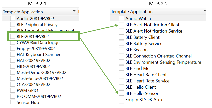

  1. The first change you will notice is the option to create required apps from the BLE, mesh or HAL group. With MTB 2.1, all apps were created from a given group with no choice. Figure 1 shows the difference in the list of apps for the BLE CE group.
    Figure 1.  MTB 2.0/2.1 CE list(left) and MTB 2.2 CE list(right) in Project Creator

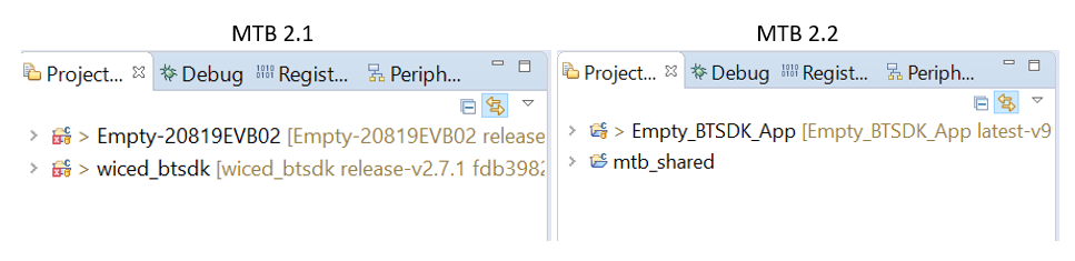

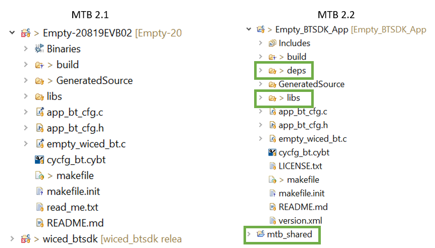

  2. In MTB 2.0/2.1, the wiced_btsdk repo needed to be cloned into the workspace before creating the application. In MTB 2.2, there is no need to create wiced_btsdk prior to the creation of app. The BTSDK apps include .mtb files for the Board Support Package (BSP) and the required libraries for the BSP are automatically detected and cloned into the shared library folder (mtb_shared) or in the libs folder in the project. Figures 2.1 and 2.2 show the difference.
      Figure 2.1. MTB 2.0/2.1 workspace vs MTB 2.2 BTSDK workspace
    Figure 2.2. MTB 2.0/2.1 BTSDK CE folder vs MTB 2.2 BTSDK CE folder

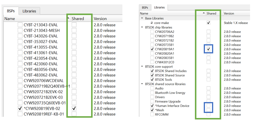

  3. The BSP and libraries can be shared or can reside locally in the project. When we say shared, it means that, all the apps created in the same workspace will use the same copy of the common libraries from the mtb_shared folder. New copies of the same shared libraries are not created for every new app. Use library manager 1.2 to make a BSP/library local or shared as shown in Figure 3 by selecting/deselecting the shared checkbox.
    Figure 3. Screenshot of library manager 1.2 to select a BSP/Library and make it shared or local
    If the BSP/library is shared, it will be created in the mtb_shared/wiced_btsdk folder. If the BSP/library is not shared, then it will be created in the libs folder in the project.

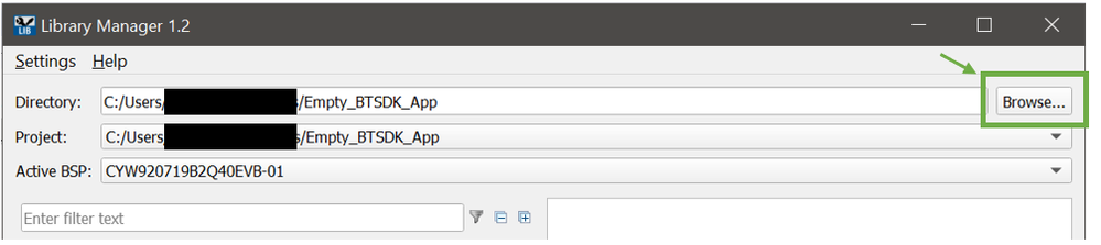

    a. Select the directory of your application using the browse option as shown in Figure 4.
    Figure 4. Screenshot of Library Manager 1.2 highlighting the ‘browse’ option
    Alternately, from the command line (modus-shell on Windows or from a command window on MacOS or Linux), navigate to the project directory and enter “make modlibs”. This will launch the library manager and will provide the correct directory.

    d. Close the library manager. Now you can observe that in your project folder two new folders called deps and libs are added. Deps and libs contain the .mtb files of the BSP/libraries you selected in previous step and the dependency libraries, respectively.
    e. In the project directory, you can see that a new folder called ‘mtb_shared’ is created. If you navigate inside the folder into wiced_btsdk, you can see the BSP/library folders downloaded. This is the shared library that we talked about earlier in the blog.
