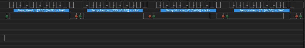

I am using STM32F303x microcontroller to established the communication with the TLE493D-W2B6 A0.
I made the reset commands as said in the manual (Start -> 0xFF -> Stop -> Start -> 0xFF -> Stop -> Start -> 0x00 -> Stop -> Start -> 0x00 -> Stop), and tried configuring the registers 0x10, 0x11 and 0x13.
3650.attach

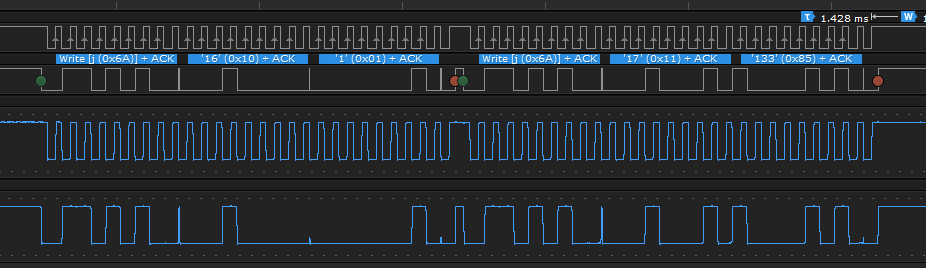

I received acknowledgement from the sensor, thus confirming the correct usage of address. Also, I was able to turn ON/OFF the INT mode of the sensor, by changing the bits in 0x11 (MOD1) register.

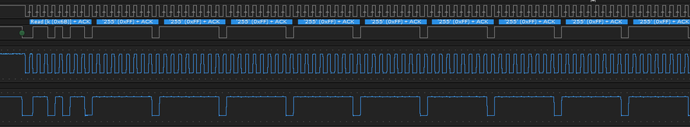

Having said that, I was not able to read any register values and even if I read, it is giving me plain 0xFF (255) and nothing else. For example, once I configured the registers, I requested for 20 bytes (0x16 is the last register). I got 0xFF in response (20 times). This included the registers that I configured with different values. Each time I receive with an ACK from the sensor, confirming the communication being established.
3652.attach
I tried a working code (arduino) for the magnetic sensor with an Arduino Micro, and the result was same. The sensor that I used with arduino and STM32 are different but the results are quiet the same. I wasn't even able to read out the value from version register.

The configuration values that I used for each register are as follows (STM32)
0x10 - CONFIG - 0x10 (no trigger bits), 0x01 (parity bit set).
0x11 - MOD1 - 0x11 (no trigger bits), 0x85 ( Two Byte Master Mode with Clock stretching enabled and INT disabled and parity bit set).
0x13 - MOD2 - 0x13 ( no trigger bits), 0x40 (update rate of 24Hz).

please doublecheck whether the used controller supports "2-byte read".
If not, please be aware of the parity bit "FP" which needs to be set accordingly if you change the communication to "1-byte read".

Hi, thanks for the reply. Right now the 1-byte read seems to be working but there has not been a clear indication regarding the Master mode and Low-power/fast mode.
Right now, I started the sensor with low-power mode, INT enabled (1-byte read). Then, in the INT handler, I had to re-configure it to Master mode (INT disabled). This enabled me to read from the sensor.
After reading the required values, I had to re-configure it back to Low-power mode with INT. This was not specified explicitely in the user manual or in the source code (GitHub). It took me sometime to arrive at this particular sequence, which seems to be working.
