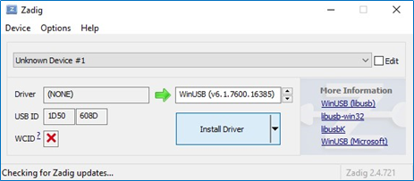

  7. Use the Zadig tool (installed along with PulseView) to bind this device to the WinUSB driver as shown in Figure 2
Once the driver is installed, a pop up appears stating that the driver was installed successfully. The device will appear as Unknown Device #1 in Device Manager.
                                                                   Figure 2. Binding to WinUSB Driver using Zadig

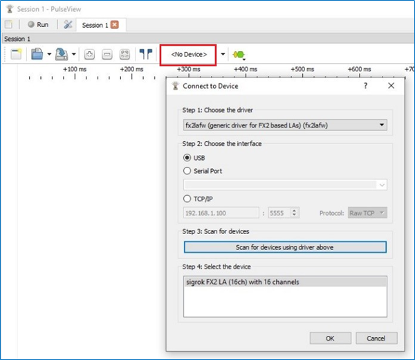

  1. Open PulseView application and check if the device is selected. If it appears as <No Device>, follow the steps below to select the device.
  2. Click the drop-down arrow and select Connect to Device.
  3. In the Connect to Device dialog, select fx2lafw as the driver.
  4. Click Scan for devices using driver above. Select the device sigrok FX2 LA (16ch) with 16 channels.
  5. Click OK.
                                                             Figure 3. Selecting the Device on PulseView

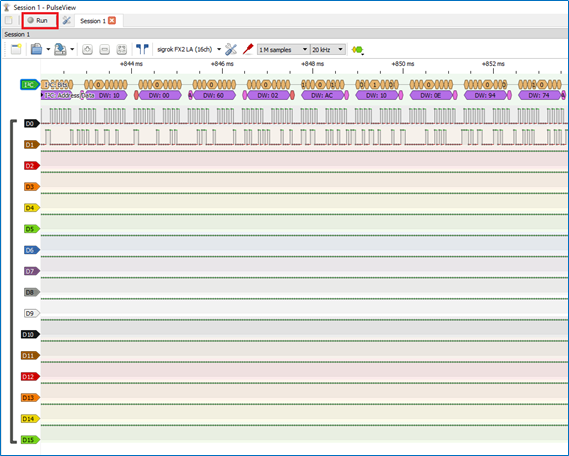

             6. Click Run to start the capture on the channels. Note that pins PB0-PB7 and PD0-PD7 on the board act as channels 0-7 and 8-16 respectively. Figure 4 shows a capture session for a device as a 16-channel logic analyzer. Channel 0 and Channel 1 show decoded capture from an I2C transaction (see Decoders from PulseView user guide for more details).
                                                                       Figure 4. Viewing Data on PulseView
