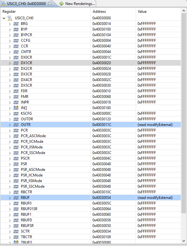

I've having an issue with my XMC4500 relex kit and usic channel. Here's my code:
As you can see it's almost a copy from the I2C example, but still doesn't give me any output ( I configured the end of transmit callback to be function tx_callback_0 and the pins to be SCl:0.8 and SDA:1.5)
and in the debugger when I lock at USIC0_C0 address I find all ones
Thanks in advance!

when you see that all the registers are in "all one" state, you can always be sure that module is not enabled (used peripheral is not powered on). In your case this should be done by the function:
Dave_Init() -> I2C_MASTER_Init(&I2C_MASTER_0) -> I2C_MASTER_0_init() -> XMC_I2C_CH_Init(XMC_I2C0_CH0, &I2C_MASTER_0_channel_config) -> XMC_USIC_CH_Enable(channel)
And why these functions are not executed in your case in the order I just mentioned 🙂 ? Can you please verify that you generated DAVE APP code?

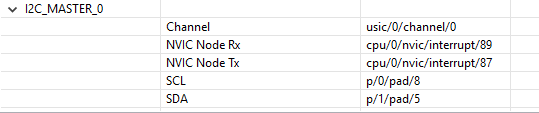

Try then to debug the code...I guess at least the registers shouldn´t be all one like now. Also, one additional advice... Due to the fact that you selected pins that belong to the module USIC0 channel 0, DAVE should automatically configure usage of that module and channel. However, just to be sure that it´s really using proper channel and that you should be looking at memory monitor for USIC0C0, you can select "Report":
And then you should see something exactly as it is shown on the figure below:
Try things above that I´ve mentioned and let me know have we at least solved something...I cannot guarantee that the code will work, that I will leave for you to check 😛

I looked into what you've said and I found that inside I2C_MASTER_Init();
As you can see there is no "I2C_MASTER_0_init()" so I added it myself (between handle->config->fptr_i2c_config(); and status = I2C_MASTER_STATUS_SUCCESS; ) , from that point ahead every function is called in the order you specified, and teh report manager shows everything as you mentioned:
but unfortunately the problem still persist, and still get the channel disabled.
