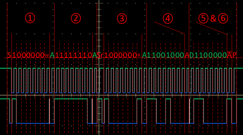

So,
not the news I was hoping to hear 😞
Nevertheless, let´s try some other things. The main problem is that I don´t have the mentioned slave device, so I cannot replicate your problem. I took a look on the net for an examples that use the mentioned device, but I just found some Arduino and LABView examples....not very useful. I´ve made some adjustments to the picture you sent me. This way it´s much more easier to follow what happens with the communication between two devices.
here you can notice several things...first I added decoding of the every bit that you´ve captured. Also, I´ve added number on top the slices which are related to the function calls. I will post code sections with appropriate number so it´s easier to follow. I can notice from this snapshot that we receive some data (green value suggest slave controlling SDA line and red values suggest master controlling SDA line). It looks, though, that this data does not correspond to the Manufacturer ID that we addressed (0xFE). I must admit that I don´t know why this is the case.
So, my further suggestions...can you please use step by step debugging and see what is the content of USIC0_CH1.RBUFD register EXACTLY once the "XMC_I2C_CH_MasterReceiveAck(XMC_I2C0_CH1)" is executed. We care only about lower 8 bits.
It should match with the data seen on the picture above (meaning, the register value should be 0xC8).
Deni
XMC_I2C_CH_MasterStart(XMC_I2C0_CH1, IO_ADDRESS, XMC_I2C_CH_CMD_WRITE); #1
XMC_I2C_CH_MasterTransmit(XMC_I2C0_CH1, MANF_ID_REG); #2
XMC_I2C_CH_MasterRepeatedStart(XMC_I2C0_CH1, IO_ADDRESS, XMC_I2C_CH_CMD_READ); #3
XMC_I2C_CH_MasterReceiveAck(XMC_I2C0_CH1); #4
XMC_I2C_CH_MasterReceiveNack(XMC_I2C0_CH1); #5
XMC_I2C_CH_MasterStop(XMC_I2C0_CH1); #6
