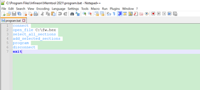

i need to flash the xmc4500 using the DAP Interface via Memtool but without open the Memtool GUI.
Any one has an Idee?

1: Please refer to the attached file memtol_batch_mode.pdf.
2: create a bat file like below screenshot. Please note that: rename your hex file as fw.hex, and place it in C disk. If not, you should change the command.
3:Place the file into the same directory like the IMTMemtool.exe.
4: Run the command line just like below screenshot.

Thanks for the answer but i have another question please. Would this command works for every xmc? or do i need a config-file?

No, you don't need the config-file.
