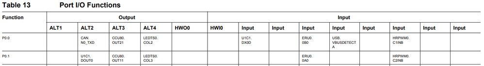

Thanks for your reply. So I have indeed been playing around with the XMC 4500's UART examples and changing the pin configurations. While I can get the code to build and compile, I don't see anything on my serial communication terminal. The way that I have configured the pins is by looking at the Distance2Go radar (device I am using) and XMC 4200 microcontroller data sheets. I have used Pins 0_0 as the UART RX and P0_1 as the UART TX. Any further ideas?

have a look at the XMC4100/4200 Data sheet and check the Port I/O Function Table where you can find connection of each pin with the peripherals...it looks like this for the selected pins:
And here you can see that pins P0.0 and P0.1 are connected to a USIC module 1 channel 1 (USIC1C1). So inside of the main function you should initialize and start different channel.
Fix that and see how it goes...other configuration looks fine.

Still not able to see serial data. I used XMC_UART1_CH1 because from the data sheet P0.0 and P0.1 is connected to U1C1 from the data sheet.
