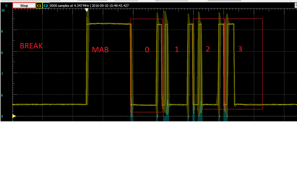

Hi
I am trying to generate some kind of signal on a particular pin. Part of that signal should be generated by ordinary GPIO actions and part of that signal should also be generated by UART.
In fact, I am trying to implement the DMX512 protocol.
What I currently do is the following:
My GPIO configuration is for pin 5.1
My UART configuration is also set for pin 5.1 , but with configuration mode equal to XMC_GPIO_MODE_OUTPUT_OPEN_DRAIN_ALT1
I can generate the BREAK and MAB signals correctly.
Sending the data over uart seems to be working too, except when I have sent my last uart frame it seems that the stop-bits are lost.
In the ISR 'dmx512_slotTransmittedInterruptHandler', I check if the last slot is sent and set everything back such that the BREAK is sent again.
I sent data for 3 slots (values 1 , 2, 3).
This is my signal. As you can see, the last slot has no stop-bits:
Is there someone who can help me. I'm struggling for it for a while already.

void dmx512_interruptHandler(void)
TIMER_ClearEvent(&TIMER_0);
if (dmx512_state == TRANSMIT_MAB) {
TIMER_Stop(&TIMER_0);
TIMER_SetTimeInterval(&TIMER_0, 1200); // MAB = 12us
TIMER_Start(&TIMER_0);
DIGITAL_IO_SetOutputHigh(&DIGITAL_IO_0);
dmx512_state = PREPARE_SLOTS;
else if (dmx512_state == PREPARE_SLOTS) {
current_slot = 0;
TIMER_SetTimeInterval(&TIMER_0, 4400); // SLOT = 44us
XMC_GPIO_Init(UART_0.config->tx_pin_config->port, UART_0.config->tx_pin_config->pin, UART_0.config->tx_pin_config->config);
dmx512_state = TRANSMIT_SLOTS;
else if (dmx512_state == TRANSMIT_SLOTS) {
UART_Transmit(&UART_0, &slot_data[current_slot], sizeof(slot_data[current_slot]));
void dmx512_slotTransmittedInterruptHandler(void)
UART_ClearFlag(&UART_0, XMC_UART_CH_STATUS_FLAG_TRANSMITTER_FRAME_FINISHED);
if (++current_slot > NUMBER_SLOTS) {
dmx512_state = TRANSMIT_BREAK;
while(1U)
switch(dmx512_state)
case TRANSMIT_BREAK:
start();
break;
default : break;
void start()
current_slot = 0;
DIGITAL_IO_Init(&DIGITAL_IO_0);
TIMER_SetTimeInterval(&TIMER_0, 17600); // BREAK = 176us
DIGITAL_IO_SetOutputLow(&DIGITAL_IO_0);
dmx512_state = TRANSMIT_MAB;
