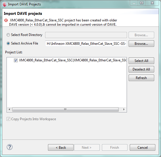

The 'XMC4800 generic EtherCAT Slave demo based on DAVE APPs (DAVE v4) and TwinCAT' from http://www.infineon.com/cms/de/product/evaluation-boards/KIT_XMC48_RELAX_ECAT_V1/productType.html?pr... is currently created with an older version than DAVE 4.2.2, therefore it is not possible to open the project with the current version of DAVE.
Is there a 'XMC4800 generic EtherCAT Slave demo based on DAVE APPs (DAVE v4) and TwinCAT' created by the DAVE 4.2.2 verison which can be added to the download folder?

Hi Alexander,
I tried the same example and it works fine for me.
It looks like, the contents of the archive file are not able to read from "H" drive.
Can you please try the following steps and let me know
1. Copy the same archive file to some other location like "C" drive where default read/write access exist
2. Import by archive option (specifying path from step 1)
OR
1. Extract archive file to local location
2. Import by folder option (specifying path from step 1)
Best Regards
Ningareddy
OR
Best Regards
Ningareddy

Hello Ningareddy,
thank you for your help, it is working now with the location change.
Best Regards
Alexander
