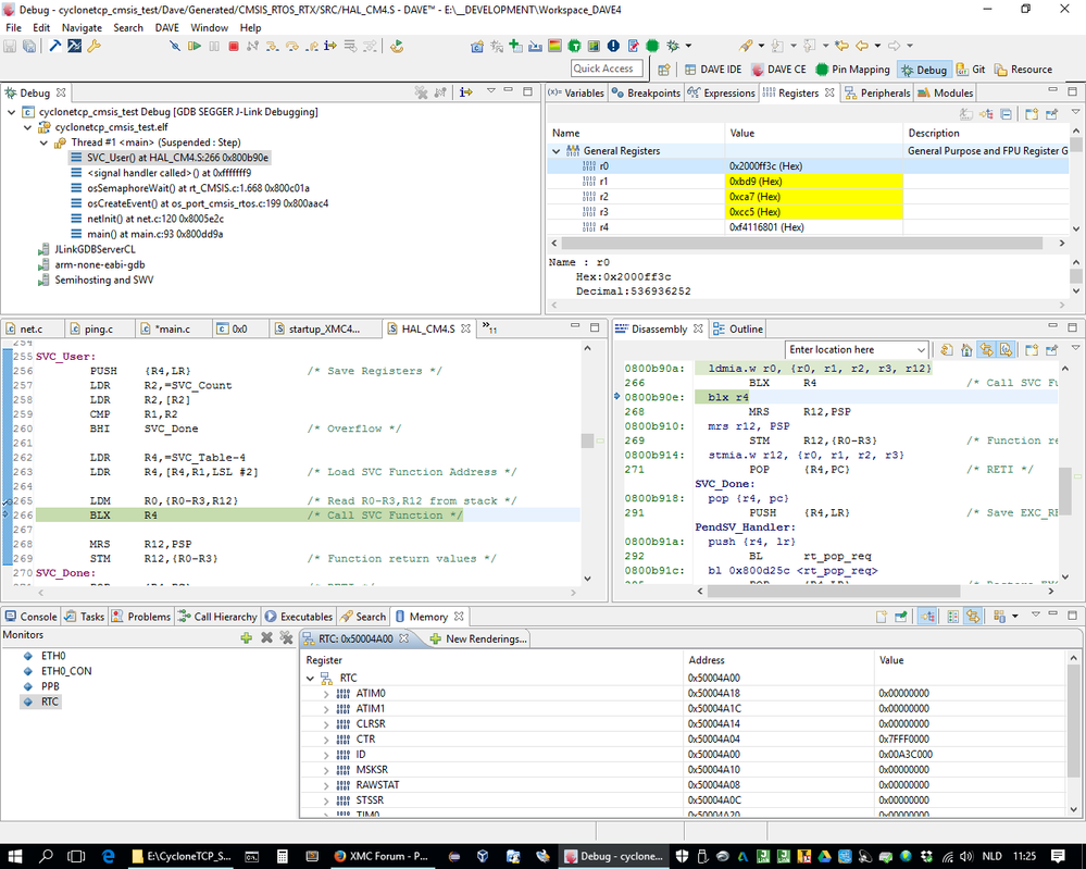

However, when I try to run the CycloneTCP example it seems that the microcontroller is blocking (?) while initialising the TCP/IP stack.
Code fragment of my main function:
The source of the netInit() function ( http://www.oryx-embedded.com/doc/net_8c_source.html#l00101 ) executes on line# 120 the method below
The call to osSemaphoreWait(event->id, 0) does not return. However, the second parameter tells me that it should return immediately.
It seems that the micrcontroller is waiting for something but I cannot figure out what it could be.

I have debugged this to the very bottom and it ultimately blocks on the call to the assemby instruction BLX R4:

I got an answer from the forum of Keil and someone says the following:
At least a starting point... Maybe, instead of DAVE 4, I better use the Keil uVision 5 IDE and see if it helps.
Some early Infineon XMC4 devices required special handling.
When you select an Infineon XMC4 device in uVision it should automatically select the appropriate RTX library.
Therefore check first if you have the correct device selected and the Infineon specific RTX library is used.
You should see the RTX_CM3_IFX.lib or RTX_CM4_IFX.lib in your project.

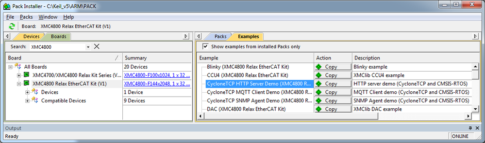

Hi Dimitri,
If you make use of Keil MDK-ARM, then you can upgrade the Oryx-Embedded::Middleware software pack to version 1.7.6. There are some example projects that demonstrate CycloneTCP + CMSIS-RTOS directly on the XMC4800 Relax Kit (HTTP server + MQTT client + SNMP agent):
