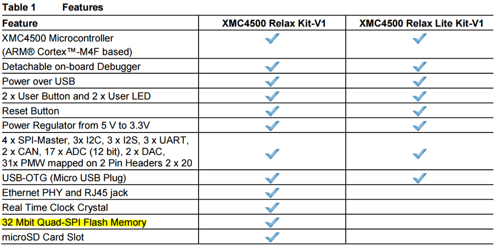

notice the following table on the page 7 in Board User´s Manual for your board and also for the XMC4500 RelaxKit:
2439.attach
So, you don´t have qSPI flash memory soldered on your board. If you open the attached .pdf document to the example you´re using, you can see that only XMC4500 CPU board is supported by that example. Of course, it´s possible to modify pins but you still need to have physical flash memory on you´re board to be able to use given qSPI example.

Hi Deni
It's Relax kit , not lite.
Sorry for the confusion.
And the SPI flash is physically present on the board.
I tried a lot but it ends in an error.
I have selected correct pins too.
