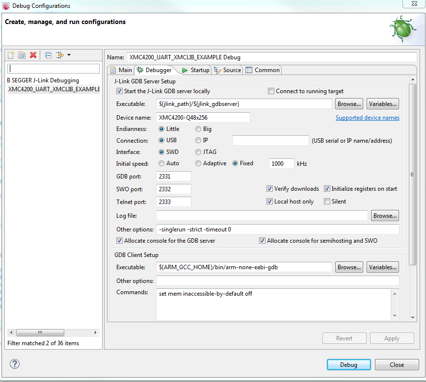

Hello everyone,
I'm still struggling with the UART(printf() style debugging).
I want to setup an UART connection using the XMClib( NO Dave APPS)
I found an UART example for the XMC1200 kit(UART_XMC_Lib_XMC12), i tried to adapt the example to the XMC4200 series but still there is no output.
Will i be able to see the output in dave or do i need another program(TeraTerm) to see the output?
In the example, the TX pin is configured as XMC_GPIO_MODE_OUTPUT_PUSH_PULL_ALT7. i'm unable to use ALT7 so i used ALT4, does this makes any difference?
Could somebody please help me solve this issue, i'm now already struggling for 3 weeks with this issue...

Hello everyone,
after 3 weeks, i was able to resolve this issue by myself.
The alternative pin function had to be 2 instead of 4...
So this line of code had to be changed:
There is little information about this...
The help from the infineon team isn't worth it at all.
Since they only say: have a look at the examples.
Since there was no UART example for the XMC4200, i started with the UART example from the XMC4500.
My error was hardware related and took me a lot of time to find out in the datasheets.
After all i did learn a lot from this error.
Thanks to everyone.
configTX.mode = XMC_GPIO_MODE_OUTPUT_PUSH_PULL_ALT2;
