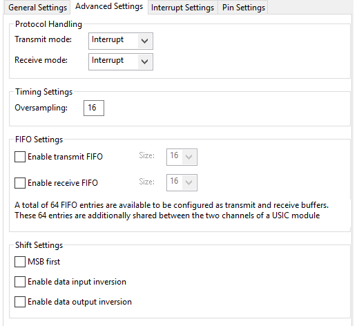

I am working with XMC1400 bootkit for an UART application. My aim is to receive an end character like =0x0D. I am trying to use UART_AbortReceive. Here are the DAVE App and code:
2920.attach
* main.c

Now if I enter exactly 5 character (let's say 12345 or 1234\r) regardless of ending character I receive my txdata on the terminal program. But other than this I got nothing. Any help will be appreciated.
User14295
I come up with the following solution.
I used Direct mode receive and put an external interrupt connected to event_std_receive. Get each byte one by one. I don't whether it is the most elegant way, but my solution is this.
Then;
