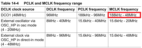

Hi Jesus,
According to:
Table 14-4 PCLK and MCLK frequency range
The frequency range for MCLK when using DCO1 as clock source is: 188kHz - 48MHz
So, even when using the maximum values for IDIV and FDIV, the minimum operating frequency of MCLK (with DCO1) is ~188kHz which is out of the range recommended in the previous reply:
Perhaps I am missing something here, or miscalculating the frequency range for MCLK when using DCO1 as clock source, but I would find very restrictive if DCO1 cannot be used as as clock source for MCLK when going to sleep/deep-sleep mode.
Could you please help me to clarify the following topics:
Thank you and BR
According to:
The maximum recommended is 4 times the frequency of DCO2 to prevent a sudden load change that could cause a brownout reset when entering sleep or deep sleep mode.
- Is there a risk of producing brownout resets when entering sleep or deep-sleep mode with MCLK=~188kHz?
- Does it mean that using DCO1 as clock source for MCLK IS NOT compatible with sleep/deep-sleep mode?
Thank you and BR
