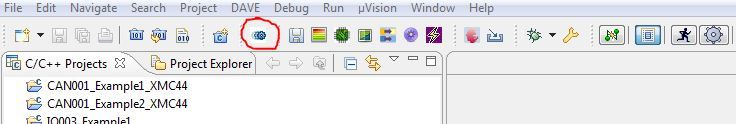

Hi, Naresh,
The new XMC1302 device has a default BMI value of ASC_BSL. The XMC1302 device on the XMC1300 boot kit was programmed to an BMI value of SWD0 debug (P0.14 as SWDIO and P0.15 as SWDCLK). So, first you need to program the BMI value of the new XMC1302 device to SWD0 debug mode. You could do this by using DAVE3 BMI Get Set Utility to change the BMI value from ASC_BSL to SWD0 debug. In the main menu of the DAVE3, click the "BMI Get Set" icon as highlight in red circle. Then, the "BMI Get Set" dialog box will appear, Click the "Select" pull down bar, select -> User Mode (debug) SWD0. Then, click the "Set BMI" button. The BMI value of the new XMC1302 device should be change to SWD0 (debug).

Hi, Naresh,
First, connect SWD to P0.14 and SWDCLK to P0.15 of the new XMC1302 device. Do a power reset on the xmc1302 device. From the Get Set BMI, click the Get BMI button, it should be able to detect ASC_BSL. Next, you could click the Select Pull down bar to select the desired SWD0 (debug) mode. Please do NOT select Productive mode, that is a Flash protection mode. It mean that the Flash is protected and cannot be accessed by the debugger anymore. Please note SWD0 is different from SPD0. Then, you click the Set BMI button.
