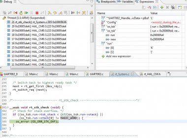

I'll try to get the UART002_EXAMPLE_XMC13 running with the RTOS. But i got the problem during runtime. The RTOS runs in a error state.. with "OS_ERR_STK_OVF"

I stuck on
and then the program ended up in "RTX_Conf_CM.c"
Somebody who knows something? Please help.

I stuck on
status_t UART002_WaitForCompletion
const UART002_LocalStructType* Config,
time_t Timeout
DBG002_FUNCTION_ENTRY(APP_GID,UART002_FUN_ENTRY);
/* Wait for completion of do-that */
//--> here the RTX runs in failure <-------
Event = osSignalWait(Config->SignalId, Timeout);
if(Event.status == osEventTimeout)
void os_error (uint32_t err_code) {
/* This function is called when a runtime error is detected. Parameter */
/* 'err_code' holds the runtime error code (defined in RTL.H). */
for (;;) {
/* HERE: include optional code to be executed on runtime error. */

i found my problem. 🙂
i have to set the compiler optimization to >0, after that the cpu was running like a charm,
