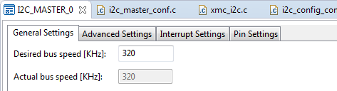

Im using the USIC module in XMC1302 boot kit as I2C and i got one question.
Its possible to set the I2C protocol signals to 320Kbps?

Hi Xabi_Odri,
under chapter 15.5 Inter-IC Bus Protocol (IIC) in the XMC1300 Reference Manual you can find information that USIC support I2C fast mode which is up to 400 kbit/s. So yes, it´s possible to set baudrate to 320 kbps.
If you´re using DAVE APPS, just set the "Desired bus speed [KHz]:" to 320:
2529.attach
If you use XMCLibs then easiest way is to have something like:
const XMC_I2C_CH_CONFIG_t I2C_MASTER_0_channel_config =
.baudrate = (uint32_t)(320000U),
.address = 0
XMC_I2C_CH_Init(XMC_I2C0_CH1, &I2C_MASTER_0_channel_config);
Of course, you need to set other options too but this should be sufficient to set the baudrate to desired value.
