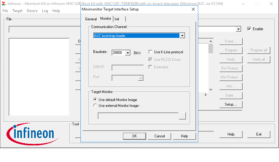

now I'm trying to change the BMI, I'm using an USB to UART converter and I've downloaded the MemTool software but it cannot communicate with the XMC.. I'm doing something wrong?

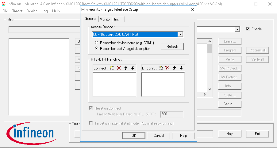

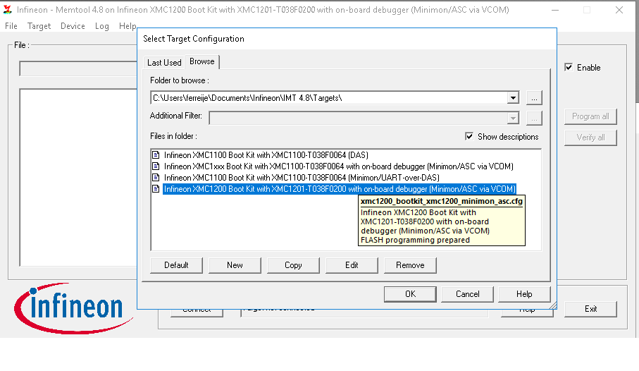

Normally the connection works out of the box.
Can you verify that you followed the steps in the following figures for configuring the ASC interface?
You can try to enable the logging (Log > Show Log).

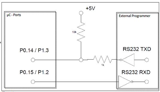

The power applied to the device is compatible with the levels of the USB to UART device?
Your connection to the device should look like the following (for the case of 5V)

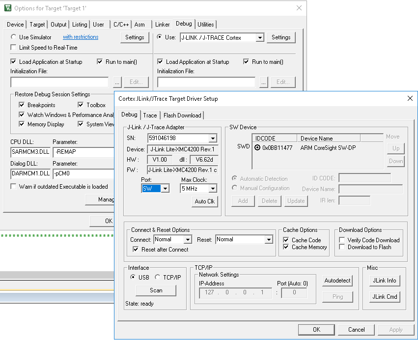

The BMI is correct. Can you try by upgrading the JLink software?
If I try the same I get the following (using latest JLink software)
These are my debug settings

Load "C:\\Files\\Projects\\MDK\\XMC1400_Test_JLINK\\Objects\\XMC1400_Test_JLINK.axf"
Set JLink Project File to "C:\Files\Projects\MDK\XMC1400_Test_JLINK\JLinkSettings.ini"
* JLink Info: Device "XMC1404-0200" selected.
JLink info:
DLL: V6.62d, compiled Mar 2 2020 09:22:41
Firmware: J-Link Lite-XMC4200 Rev.1 compiled Mar 1 2019 11:28:26
Hardware: V1.00
S/N : 591046198
* JLink Info: Trying to identify target via SPD
* JLink Info: Could not identify target via SPD. Trying again via SWD.
* JLink Info: Found SW-DP with ID 0x0BB11477
* JLink Info: Unknown DP version. Assuming DPv0
* JLink Info: Scanning AP map to find all available APs
* JLink Info: AP[1]: Stopped AP scan as end of AP map has been reached
* JLink Info: AP[0]: AHB-AP (IDR: 0x04770021)
* JLink Info: Iterating through AP map to find AHB-AP to use
* JLink Info: AP[0]: Core found
* JLink Info: AP[0]: AHB-AP ROM base: 0xF0000000
* JLink Info: CPUID register: 0x410CC200. Implementer code: 0x41 (ARM)
* JLink Info: Found Cortex-M0 r0p0, Little endian.
* JLink Info: FPUnit: 4 code (BP) slots and 0 literal slots
* JLink Info: CoreSight components:
* JLink Info: ROMTbl[0] @ F0000000
* JLink Info: ROMTbl[0][0]: E00FF000, CID: B105100D, PID: 000BB471 ROM Table
* JLink Info: ROMTbl[1] @ E00FF000
* JLink Info: ROMTbl[1][0]: E000E000, CID: B105E00D, PID: 000BB008 SCS
* JLink Info: ROMTbl[1][1]: E0001000, CID: B105E00D, PID: 000BB00A DWT
* JLink Info: ROMTbl[1][2]: E0002000, CID: B105E00D, PID: 000BB00B FPB
ROMTableAddr = 0xF0000000
* JLink Info: Performing XMC1000 reset
Target info:
Device: XMC1404-Q064x0200
VTarget = 3.300V
State of Pins:
TCK: 0, TDI: 0, TDO: 0, TMS: 16, TRES: 0, TRST: 1
Hardware-Breakpoints: 4
Software-Breakpoints: 8192
Watchpoints: 2
JTAG speed: 3000 kHz
Erase Done.
Programming Done.
Verify OK.
Flash Load finished at 15:19:02
