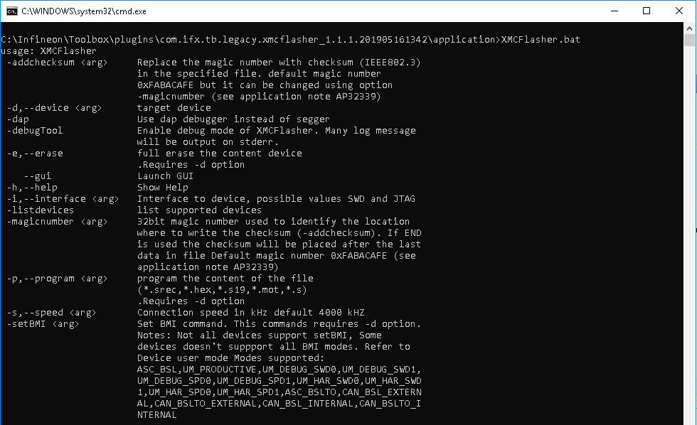

The Flasher was able to run from command line. Has this capability been removed?
We want to be able to run it from another program.

If you click in the Details button of XMCFlasher in Infineon Toolbox, two links will appear to access the license and release notes. Click on any of them. A windows explorer will open. If you navigate one folder up you will see the application folder where you will find the XMCFlasher.bat.
You can open a CMD Prompt in the application folder and run the XMCFlasher.bat.
Alternatively to XMCFlasher you could use JLink Commander (see Using J-Link Command Files section) or Infineon Memtool
These tools can be also scripted.
