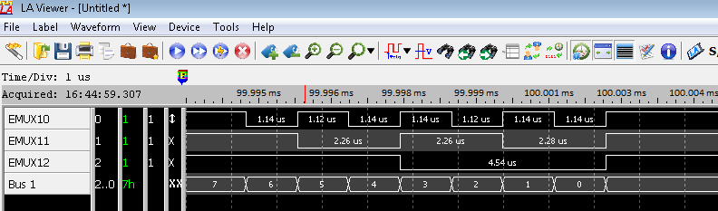

Hi
See code below, highlighted is the codes of lines added to the basic XMCLib example to enable the external mux.

// EMUX interface 1 (P2.10, P2.14 and P2.15) linked to ADC G0
XMC_VADC_GLOBAL_BindGroupToEMux(VADC, 1, 0);

XMC_GPIO_SetMode(P2_10, XMC_GPIO_MODE_OUTPUT_PUSH_PULL | P2_10_AF_VADC_EMUX10);
XMC_GPIO_SetMode(P2_14, XMC_GPIO_MODE_OUTPUT_PUSH_PULL | P2_14_AF_VADC_EMUX11);
XMC_GPIO_SetMode(P2_15, XMC_GPIO_MODE_OUTPUT_PUSH_PULL | P2_15_AF_VADC_EMUX12);
