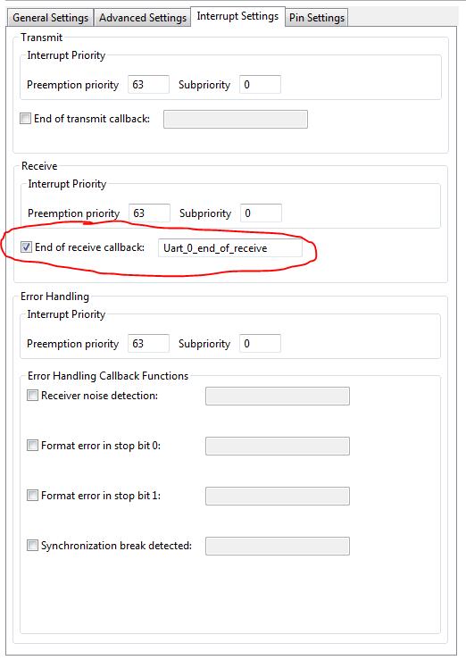

since the exhibition "embedded world" in Germany, Im totally new in the infineon world. I got a XMC1300 and the DAVE 4 IDE. I enjoyed working with it. Very easy to use, but with the "UART" App I have a problem. I configured the app:
General: Full Duplex, 19200, 8, 1, No Parity
Advanced: 16 Oversampling, Enable transmit FIFo 16, Enable Receive FIFO: 16
Interrupt Settings: End of transmit Callback: EndOfTransmit, End of Receive Callback: EndOfReceive
From the help I have the following code and copied it to my Receive ISR.
My goal is, that I can input any command that ends with an carriage return. As a second step I want to differ between different commands.
I expected, that the routine starts if something received. After that it starts the receiption which is aborted by receiving a carriage return.
But it doesnt work.
I also tried to disable the endoftransmit and endofreceive functions and copied everything to the while loop. But this does also not work.
How can I reach my goal.
The easiest way would be if I had an ISR if one character is received.

Hi toxico,
You can choose to use Standard Receive Interrupt where the interrupt will trigger when every data word received.

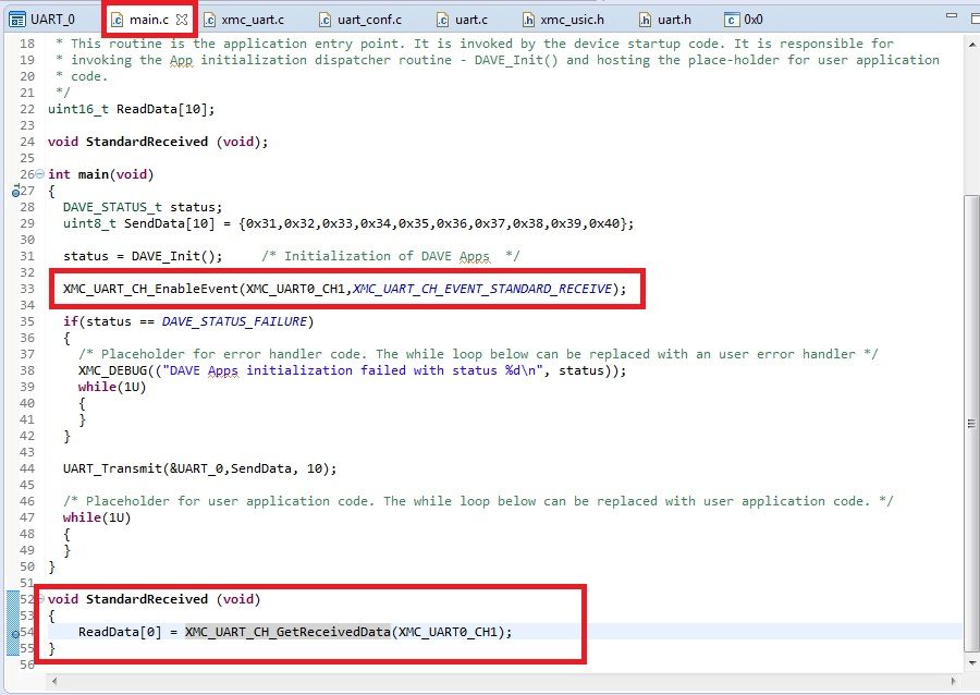

Hi toxico,
After looking at the DAVE4 UART APP, it seems the use case only support FIFO.
So in this case, to receive one byte each time, you have to use the xmc_uart XMCLib for your application.
In the UART APP, disable the FIFO setting (uncheck the enable FIFO box) in 'Advance Setting' and don't set anything on the 'Interrupt Setting'.
After you have generated the code, go to the file uart_conf.c under UART folder.
Add your receive function declaration with extern (i.e.: extern void StandardReceived (void)) to that file and replace your function in UART_0_rx_handler().
Then in your main.c, add the enable interrupt for Standard receive with XMC_UART_CH_EnableEvent(XMC_UART0_CH1,XMC_UART_CH_EVENT_STANDARD_RECEIVE);
Then, add your receive function and use XMC_UART_CH_GetReceivedData to get your received data.
Note: With this workaround, should you need to regenerate your code again, you have to add back the code that you have made in uart_conf.c after code generation.
