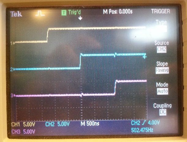

Hello!
I got to test the synchronization start of the counters and it works very nice.
The difference can clearly be seen below, where I have measured the PWM outputs generated by the three counters using the same Duty Cycle.
No synchronized start:
Synchronized start:
Thanks a lot! 🙂
Synchronized start:
Thanks a lot! 🙂
