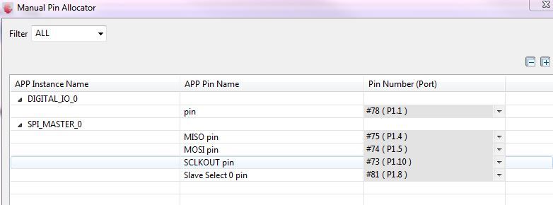

I am using Dave 4 with latest Dave apps available. Great tool !
I try to use the Serial SPI Flash available on XMC4500 Relax Kit.
I take the example of XMC4500 Hexagon, and change
The MCU model migration (from 144 to 100 pins)
the manual assignment pin settings to match Relax Kit
Does not work 😞
I tried several changes (Interrupt / Direct) Pin settings, etc...
I have measured correct signals on CS, SCL and MOSI,
but MISO signal remains silent.
Is there any public example allowing to access this device ?
Thanks a lot for your support

Found it !!
After looking more carefully at the differences between Hexagon (working) and Relax (not working) projects,
I found that for some unknown reason, following line has been added in
static SPI_MASTER_STATUS_t SPI_MASTER_0_lInit(void)
XMC_SPI_CH_DisableFEM(XMC_SPI0_CH0);
This is not correct, make sure the Frame End Mode is on
