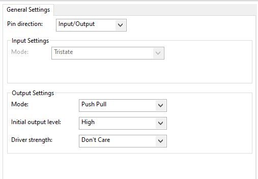

I am manually updating the pin settings for the XMC4500-F100x1024 in order to utilize the SPI_EXAMPLE_XMC45 App and access the external Flash.
Using DAVE I can read and make out the pin settings for the SPI_MASTER but for the DIGITAL_IO, the setting is optimized for the XMC4500-F144x1024 and
I cannot make out which option I have to pick.
Can someone help me?

Hi Kyalpani,
Your request was not clear from the description ? From the project dave app configuration, the DIGITAL_IO pin setting is as follows. Are you interested in this ?
This is used to control the on board LED. If not, let me know what you are trying to do.

Thank you and I agree with your comment. Background: I am trying to make the SPI_EXAMPLE_XMC45 app work on the xmc4500 relax-kit.
So I migrated the project to the XMC4500-F144x1024 architecture using
the "DAVE Project Upgrade->Device Migration" menu option, in "App Dependencies" under "SPI_MASTER", I selected
"High if inactive, transmit on falling clock edge, receive on rising clock edge"
and (just to be safe) initiated a "Generate Code" . I built and installed and debugged:
in main.c:142 "N25Q03_StatusRead();" always returns '0' which means that " N25Q03_WriteEnable();" of the previous statement actually did not enable write.
So, judging by your answer, I erred and thought DIGITAL_IO could have something to do with the problem.
Do you have any idea what I could try?
