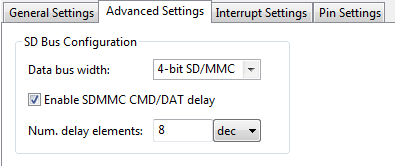

Which version of the APP are you using?
Have you tried enabling the delay?

Hi Jesus,
thanks for the reply.
The GUI you posted is for the SDMMC_BLOCK in SD mode. I am using SPI mode!
By the way, If I use SD mode, everything works fine on the same hardware with the same SD card.
But unfortunately I can not use the SD mode in my final hardware so I have to use SPI mode.
