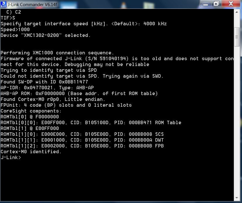

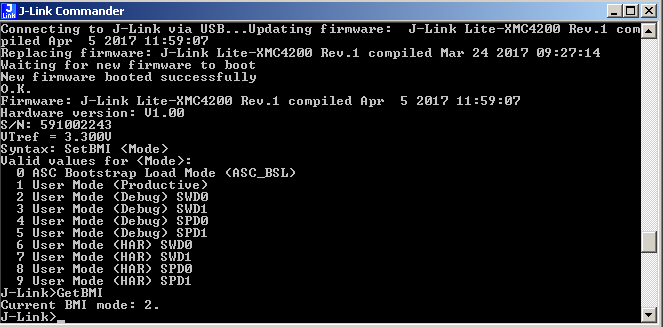

We have been using XMC1300 J-Link Lite Bootkit to Get/Set BMI, Program and Debug XMC1302. We have ordered four new XMC1300 J-Link Lite Bootkits last month. With our old bootkit (the same model but previously ordered than these four), we were able to do all these three operations. But I am afraid to let you know that we are not able to Get/Set BMI from these new Kits though we are able to program and debug. The error states that we have to update the driver, we also did that. Now the driver is up-to-date. FYI, this problem lies in both DAVE 3.1.8 and DAVE 4.1.2.We are quite an old customer of Segger and Infineon, so I kindly request you to help us resolve this issue as soon as possible.

I was referreing to the JLink version not to the board version.
The current JLink version is v6.14f.
You can also use the JLink commander. In the Start Windows menu, in the SEGGER/J-Link folder click in JLink Commander.
2649.attach
@Jesus: I went to try on JLink Commander. It was able to recognize my device, but It stated that the firmware of JLink is too old.2650.attach
