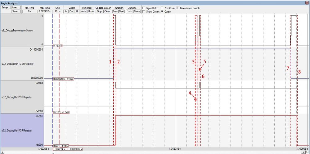

I reproduced the old code...this is what I see in the logic analyzer:
The variable "u8_DebugTransmissionStatus" is the variable I set to 1 at the beginning of the Interrupt. At the end of the function it will be set to 0 again.

Hello Niclas,
From your description, I am suspecting that the transmit shift interrupt (TSIF) is also enabled.
This interrupt is triggered with the shift of the last data bit so roughly one bit time earlier than TFF.
Can you check this by reading out the CCR register? Specifically, bit 12 controls the TSIF interrupt generation.
I doubt that the TFF event is triggering the additional interrupts.

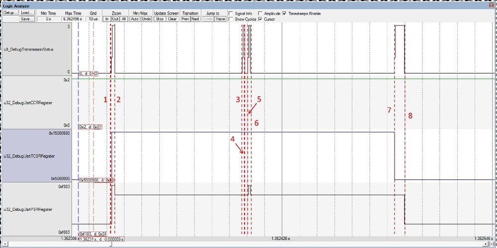

Hi Min Wei,
I went ahead and added some variables to the Interrupt function. Those Variables read out certain Registers at the beginning and the end of the Interrupt function. The Registers in the first measurements are CCR, TCSR and PSR and in the second measurement TCSR, PSR and PCR. The variables are also put into the logic analyzer. This is the result for CCR, TCSR and PSR:
In the Picture I added some numbered lines. These are the register-values at the corresponding line:
Line 1:
CCR = 0x00000002
TCSR = 0x15000580
PSR = 0x0000F583
Line 2:
CCR = 0x00000002
TCSR = 0x15000580
PSR = 0x0000F483
Line 3:
CCR = 0x00000002
TCSR = 0x15000580
PSR = 0x0000F483
Line 4:
CCR = 0x00000002
TCSR = 0x15000580
PSR = 0x0000F483
Line 5:
CCR = 0x00000002
TCSR = 0x15000580
PSR = 0x0000F583
Line 6:
CCR = 0x00000002
TCSR = 0x15000580
PSR = 0x0000F483
Line 7:
CCR = 0x00000002
TCSR = 0x05000500
PSR = 0x0000F483
Line 8:
CCR = 0x00000002
TCSR = 0x05000500
PSR = 0x0000F183
And here the second measurement with the Registers TCSR, PSR and PCR:
Line 1:
TCSR = 0x15000580
PSR = 0x0000F583
PCR = 0x00000901
Line 2:
TCSR = 0x15000580
PSR = 0x0000F483
PCR = 0x00000981
Line 3:
TCSR = 0x15000580
PSR = 0x0000F483
PCR = 0x00000981
Line 4:
TCSR = 0x15000580
PSR = 0x0000F483
PCR = 0x00000981
Line 5:
TCSR = 0x15000580
PSR = 0x0000F583
PCR = 0x00000981
Line 6:
TCSR = 0x15000580
PSR = 0x0000F483
PCR = 0x00000981
Line 7:
TCSR = 0x05000500
PSR = 0x0000F483
PCR = 0x00000981
Line 8:
TCSR = 0x05000500
PSR = 0x0000F183
PCR = 0x00000901
I cannot see that it is TSIF that fires that one particular additional interrupt.
Niclas

Here some more Registers corresponding to the numbered lines in the Pictures above:

One can see that the RxFifo gets filled during Transmission due to the half duplex nature of the UART-configuration. However, receive-interrupts are deactivated during transmission and the Interrupt Output-line is not the same line as for transmit-interrupts, so that shouldn't be the reason for the Problem.

Hello Niclas,
Thanks for providing these details. It is clear to me now, the extra interrupt is due to the received frame finished event (RFF).
RFF shares the same interrupt enable as TFF, i.e. PCR.FFIEN and with half-duplex UART configuration, data reception is taking place at the same time as data transmission.
This can be seen from your observations on the PSR register.
- The interrupt triggered at line 3 is due to RFF of the 2nd last received word. Hence at line 3 and line 4, RFF remains set and TFF is 0.
- The interrupt triggered at line 5 is due to TFF as shown in PSR.TFF=1.
- At line 6, PSR.TFF is cleared to 0 by your service routine.
- The interrupt triggered at line 7 is then due to the RFF of the last received word. PSR.TFF remains 0 at this point in time.
- But here do you clear PSR.RFF because at line 8, I see that PSR.TFF=1 but PSR.RFF=0.
RFF is happening about half a bit time earlier than TFF. This because from receive perspective, the sampling points determines the completion whereas from transmit perspective, the completion is based on the end of the internal shift clock cycle.
For your application, would it make sense to treat RFF as dummy interrupts and service only the interrupts triggered by TFF? In your service routine, you can check if PSR.TFF bit is set.
Min Wei
Min Wei

Hi Min Wei,
thank you very much! I didn't notice that receive and transmit share the same Frame finished Interrupt! Now that I know what the problem is I will find a solution that fits best. Maybe, as you said, by ignoring the Interrupt call or maybe by waiting until PSR.TFF is also set. Again, thank you!
Niclas
Niclas
