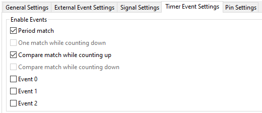

in my project using an XMC1100 with DAVE Apps I trigger ADC_MEASUREMENT by an PWM_CCU4
on Period match as well as Compare match while counting up.
An interrupt handler for ADC_MEASUREMENT then evaluates the results.
Since I switch a power MOSFET with the PWM output signal my measurements have rather different meanings
whether PWM is in active vs. inactive phase. How can I determine in which phase the PWM_CCU4 is currently?
PWM frequency is low (sub 1kHz). Thus PWM state will not have changed from the one it had during the ADC
did its measurements.
By the way, PWM_CCU4 will not signal Compare match while counting up when Duty Cycle is set to 0.0%, right?

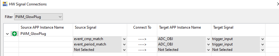

Triggering the ADC conversion from the PWM CCU4 works fine for me as long as I trigger only on "Compare match while counting up". Since I want to trigger on start as well as the end of the active PWM cycle I tried this:
Now the ADC conversion will not trigger any more at all.
I had to introduce an additional Interrupt App which is triggered on the CCU4 "Period match". In the IRQ handler routine the ADC conversion is then started. Not a beautiful workaround.
