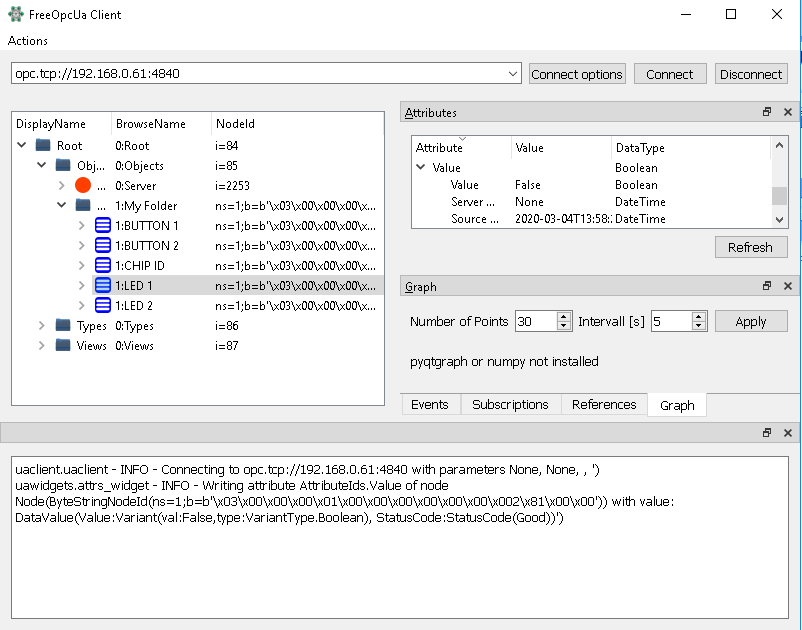

I just tested the example in the XMC4700 RelaxKit and there it is working without problems.
