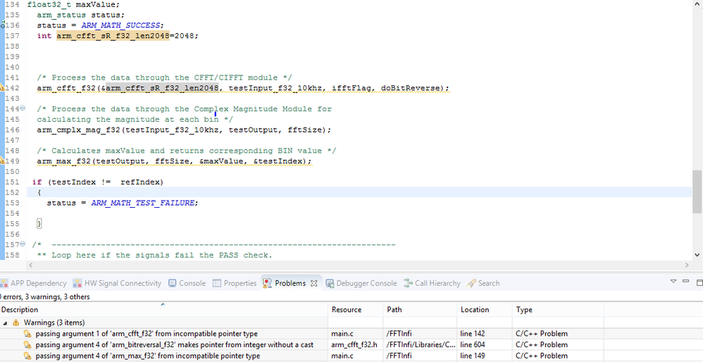

int arm_cfft_sR_f32_len2048=2048;
/* Process the data through the CFFT/CIFFT module */
arm_cfft_f32(&arm_cfft_sR_f32_len2048, testInput_f32_10khz, ifftFlag, doBitReverse);
/* Process the data through the Complex Magnitude Module for
calculating the magnitude at each bin */
arm_cmplx_mag_f32(testInput_f32_10khz, testOutput, fftSize);
/* Calculates maxValue and returns corresponding BIN value */
arm_max_f32(testOutput, fftSize, &maxValue, &testIndex);
if (testIndex != refIndex)
status = ARM_MATH_TEST_FAILURE;

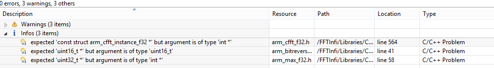

I got a list of 3 warning :
Also there is 3 info for the function contains in headers :

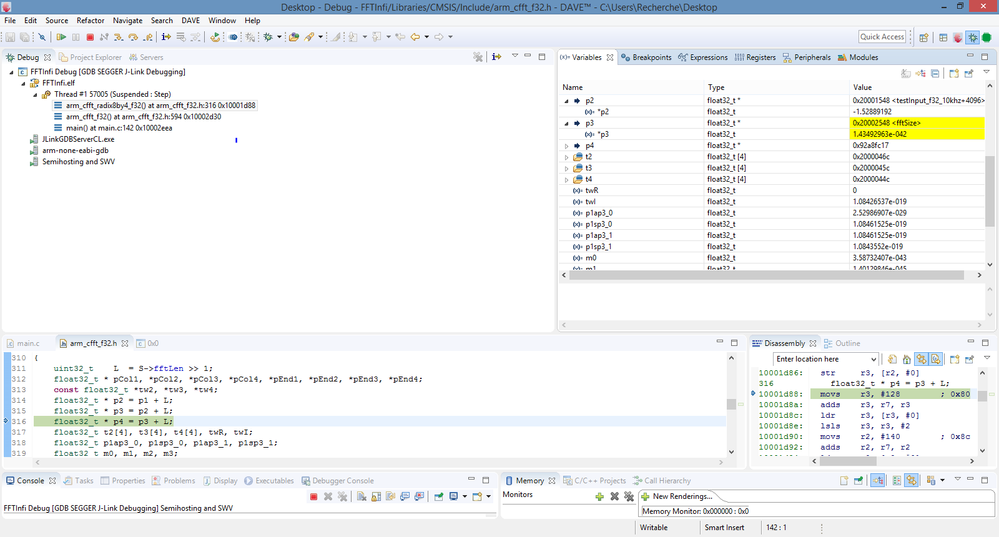

When i use the debugger, i observe that there is anormal things for the following lines :
He is not affecting the great value for p2 and seems to not give any value to p3 and p4.
I hope that i gave you all the necessary information to help me resolve my problem.
