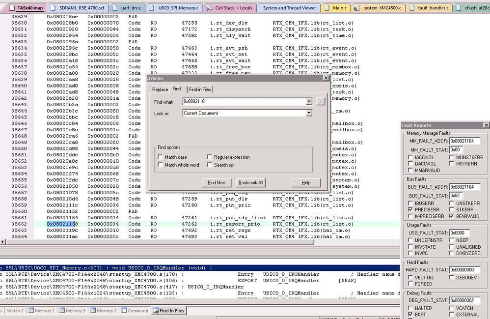

Here are the Infos:
stacked_r0 = 0x20000084;
stacked_r1 = 0x00000001;
stacked_r2 = 0x20000084;
stacked_r3 = 0x0000403E;
stacked_r12 = 0x080238C3;
stacked_lr = 0x080214C9;
stacked_pc = 0x08021154;
stacked_psr = 0x0100000F;
_CFSR = 0x00008200;
_HFSR = 0x00000000;
_DFSR = 0x00000000;
_AFSR = 0x00000000;
_BFAR = 0x08021164;
_MMAR = 0x08021164;
_BFAR points to rt_put_rdy_first() from CMSIS RTOS Lib which is probably called from SysTick_Handler().
Here the corresponding output from the MAP-File:
0x08021152 0x00000002 PAD
0x08021154 0x00000014 Code RO 47261 i.rt_put_rdy_first RTX_CM4_IFX.lib(rt_list.o)
0x08021168 0x00000034 Code RO 47262 i.rt_resort_prio RTX_CM4_IFX.lib(rt_list.o)
0x0802119c 0x00000010 Code RO 47692 i.rt_ret_regs RTX_CM4_IFX.lib(hal_cm.o)
In this try the Trap is released while in SysTick_Handler.
If we apply minor changes to the project the trap address changes.
The only common we found is that the traps are released during DMA Transfers.
In this case we have DMA Transfers between an USIC in SPI Mode and external RAM Memory.
The traps are sporadically. (We have about 1 Trap during 100 DMA Transfers).
The Transfers are Single Block Transfers with 4096 Byte per Transfer.
We do not encounter any Traps when the Transfer is between USIC in SPI Mode and internal RAM Memory.
The Clock Configuration (fcpu, fpll, febu,..) are the same as on XMC4500 (fcpu,fpll=120MHz, febu=120MHz).
Ebu Configuration is the same as in XMC4500.
I can give you further Infos about Clock Configuration, EBU Configuration and PCB and the External Memories if you want.
The same PCB works fine with XMC4500
If you want any further information please let me know

Could you tell me what is the code at 0x080214C9?
Could you check if any of the memory arrays involved in the DMA transfer cross memory borders, i.e. from PSRAM to DSRAM1 or DSRAM1 to DSRAM2?

The code at 0x080214C9 belongs to
i.rt_systick RTX_CM4_IFX.lib(rt_system.o)
which is called from the SysTick_Handler.

When the fault occurs, could you check the value of the DMA raw error interrupt status?
Is it possible for you to post a minimal program showing the error?

Thank you for the feedback, I created crash again on our system and saw Flash Single and Double bit error were set.
Looks like same issue. So i reduced driver strength to strong/Medium instead of Strong/sharp and ran it in release mode and saw system crashing again. If i reduce strength to any value lower than strong/medim then my system don't see any signal on EBU lines.
Is there anything else you did to resolve this issue apart from reducing driver strength ? Did you make any modification in hardware ?
