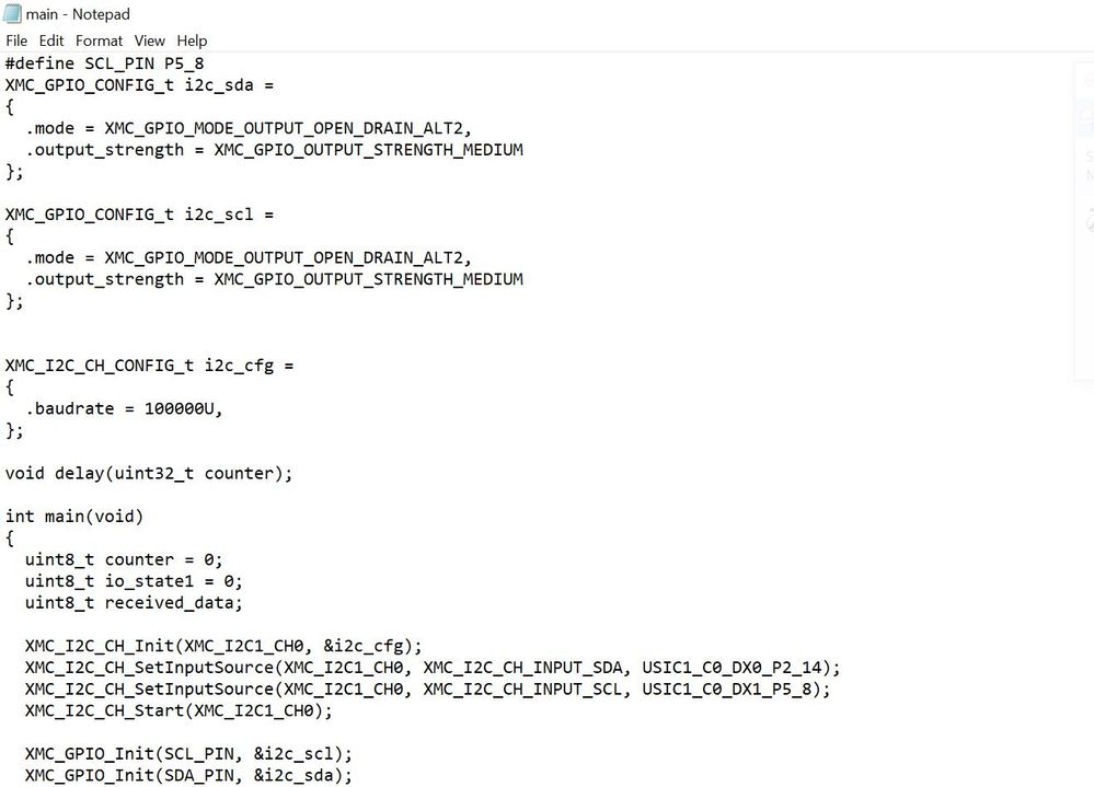

Hi @marq86,
Assuming that the code which you have shared is the entire main.c file here, there are a few points you need to check before I2C can be made to work -
1. Please try configuring the SDA and SCL pins as per the required I2C configuration such as their mode and output strength.
2. You need to set the Baud-rate for I2C transfer.
3. Select the appropriate input source channels of the USIC module, which will be configured as I2C.
We regret to inform that we presently do not have I2C code example, devised for XMC 1100 device but I have shared an image below from the xmc-4500 I2C_TRANSER code example which is a part of xmc-library. This image will help you understand the flow of code for the working of I2C.
Please go through this code example and the image so as to try at your end and let us know in case of any query.
Aashita
Aashita
