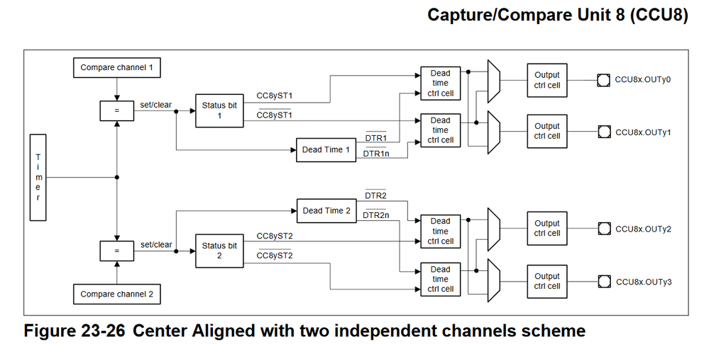

The inverted and not inverted Signals are a feature of the CCU8.
Generally they are made to behave exactly like this because this is required at their major application: half bridges.
In the XMC45 you can generate per slice: 2 PWM Signals with independent duty cycle but the same frequency. + the inverted signals.
The best picture to see this is the Figure 23-26 in the reference manual (page 2347 @v1.6)

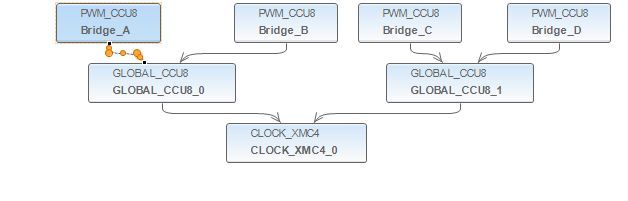

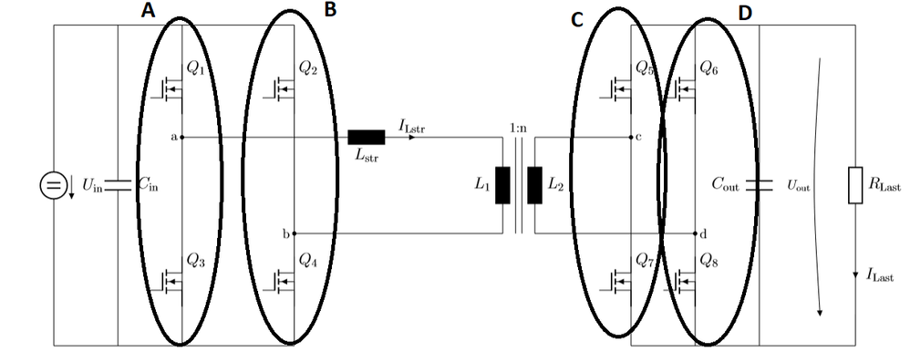

I needed 8 PWM ( 4 inverted) to control a Dual active bridge, im using CCU80.out20/CCU80.out21 to control the Half bridge A CCU80.out30/CCU80.out31 and to control B, CCU81.out00/CCU81.out01 and CCU81.out20/CCU81.out21 to control D see the the picture blow
With DAVE PWM_CCU8 im getting close to my aim
now with GLOBAL_CCU8_SyncStartTriggerHigh(GLOBAL_CCU8_CCUCON_Msk); im Starting all the PWM at the same Time.
my question now, how can i Start the half bridge D and C at the same time but after a Phase shift so they start after A and B

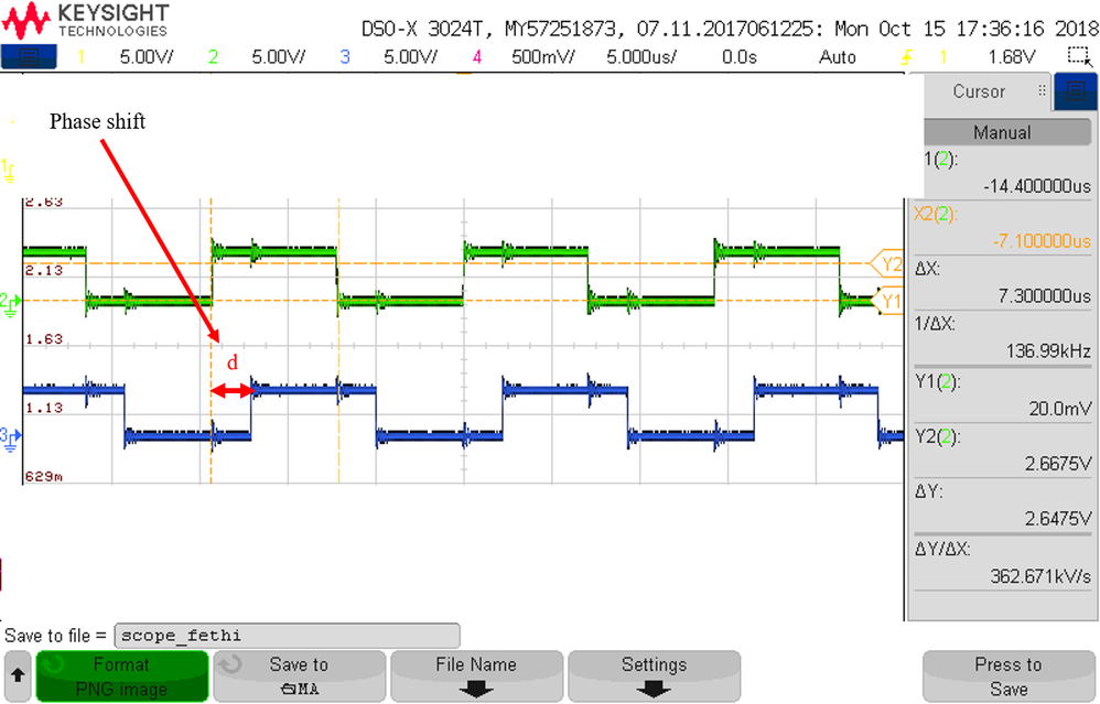

Hi im getting with this code a phase shift between the two full-bridges

but i can not control it 😕 if i change the postion of "XMC_SCU_SetCcuTriggerHigh"i get a variation but im not pleased i need to find how to change the length of d

Hi Fethi,
you need to start the timer first.
The APP is checking if you have enabled sync. Start. if this is the case it will only init the timer and not run.
Then you have to write into the timer register. Because the CCU needs to be initialized but the timer must not run.
After this you can enable the Trigger for all Moduls.
The timer Set value was not defined as standard function for the PWM_CCU8 APP so there is no API for it.
But you already wrote the solution by using the LIB function.
In my example I enabled the sync start for two PWM_CCU8 APP instances: PWM_CCU8_0 and PWM_CCU8_1:
PWM_CCU8_Start(&PWM_CCU8_0);
PWM_CCU8_Start(&PWM_CCU8_1);
XMC_CCU8_SLICE_SetTimerValue(PWM_CCU8_0.ccu8_slice_ptr,10000);
XMC_SCU_SetCcuTriggerHigh(XMC_SCU_CCU_TRIGGER_CCU80|XMC_SCU_CCU_TRIGGER_CCU81);
Regards
Eric

Hi Eric,
thanks it works :)!!
this is my code:
PWM_CCU8_Start(&Bridge_A);
PWM_CCU8_Start(&Bridge_B);
XMC_CCU8_SLICE_SetTimerValue(Bridge_A.ccu8_slice_ptr,400); /** ccu8_slice_ptr XMC_CCU8_SLICE_SetTimerValue(Bridge_B.ccu8_slice_ptr,400); /** ccu8_slice_ptr
PWM_CCU8_Start(&Bridge_C);
PWM_CCU8_Start(&Bridge_D);
XMC_CCU8_SLICE_SetTimerValue(Bridge_C.ccu8_slice_ptr,200); /** ccu8_slice_ptr XMC_CCU8_SLICE_SetTimerValue(Bridge_D.ccu8_slice_ptr,200); /** ccu8_slice_ptr;
//Synchronously start PWM_CCU8_0 and PWM_CCU8_1 Slices*/
