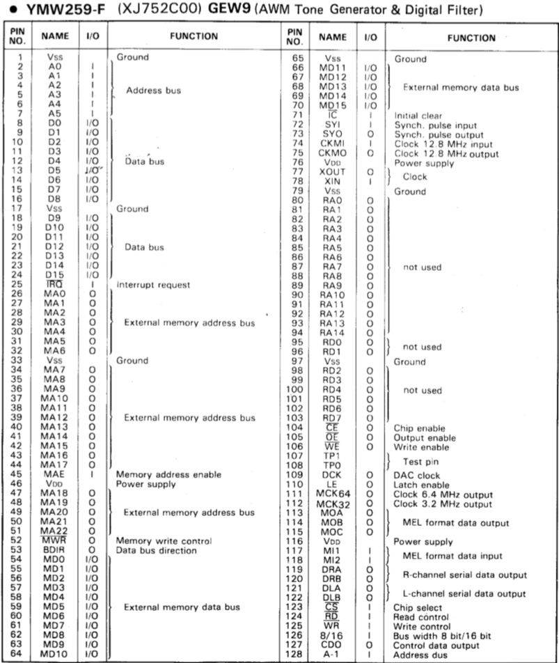

I have done the same project in Poland cheap electronic keyboard instrument on cheap and available in china IC-F GEW9 YMW259 wavetable generator and do not quite know how to connect with GEW9 XMC4500 (YMW259-F), standard yamaha uses microcontrolleres RENESAS H8 their obsolete electronic keyboard PSR 5700 / PSR6000, but they do not have support for touch screen color and the FLASH memory
if any of you know
How to connect Infineon XMC4500 with IC - Yamaha YMW259-F (GEW9)
it seems that the data bus and address are parallel in YMW259-F

Sorry to say that you need to be more precise and detailed in your questions. It would be better if you can understand the interface of the Yamaha IC such as using I2C, UART, CAN etc before we can suggest anything.

See the picture manual , the main CPU is the original old solution GEW8 with old microcontroller Renesas/Hitachi - H8 family
