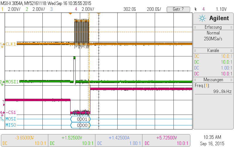

I saw that I use XMC_UART_... functions after I initialised the GPDMA. I changed it and now I uses XMC_SPI_CH_EnableEvent() and XMC_SPI_CH_TriggerServiceRequest().
Is the function XMC_SPI_CH_SetInterruptNodePointer() necessary?
Now, the master send only one Datapackage (the first one) as you can see on the scope.

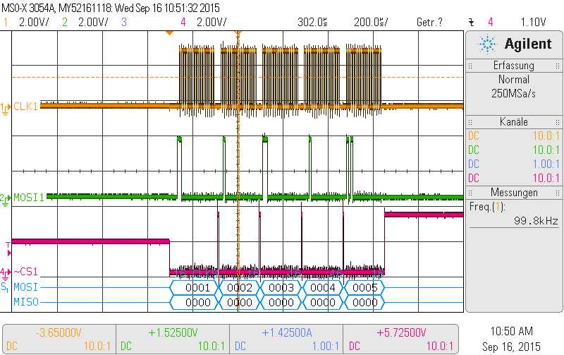

After I Change the
to
and
the master send all data packages but the slave isn't correct.
Is the init of the DLR right? Or have I some mistake?
After I Change the
XMC_DMA_CH_CONFIG_t dma_ch_config_master =
.dst_handshaking = XMC_DMA_CH_DST_HANDSHAKING_HARDWARE,
.dst_peripheral_request = DMA0_PERIPHERAL_REQUEST_USIC1_SR1_2, // SR = 1, Line = 2;
to
.dst_peripheral_request = DMA0_PERIPHERAL_REQUEST_USIC1_SR0_0, // SR = 0, Line = 0;
XMC_DMA_CH_CONFIG_t dma_ch_config_slave =
.src_peripheral_request = DMA0_PERIPHERAL_REQUEST_USIC0_SR0_1, // SR = 0, Line = 1;
and
/* MASTER DMA */
#if 1
XMC_DMA_Init(XMC_DMA0);
XMC_DMA_CH_Init(XMC_DMA0, 2, &dma_ch_config_master);
XMC_SPI_CH_SetInterruptNodePointer(XMC_SPI1_CH1, 0);
XMC_SPI_CH_EnableEvent(XMC_SPI1_CH1, XMC_SPI_CH_EVENT_TRANSMIT_SHIFT);
XMC_SPI_CH_TriggerServiceRequest(XMC_SPI1_CH1, 0); /* make DMA ready */
#endif
/* SLAVE DMA */
#if 1
XMC_DMA_CH_Init(XMC_DMA0, 3, &dma_ch_config_slave);
XMC_SPI_CH_SetInterruptNodePointer(XMC_SPI0_CH0, 0);
XMC_SPI_CH_EnableEvent(XMC_SPI0_CH0, XMC_SPI_CH_EVENT_STANDARD_RECEIVE);
XMC_SPI_CH_TriggerServiceRequest(XMC_SPI0_CH0, 0); /* make DMA ready */
#endif

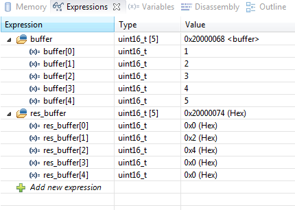

I think that the alternate receive event needs to be enabled as well, on top of the receive event:
With this, it is also no longer necessary to manually force a service request to the DMA channel for the slave (commented out in the code above).
