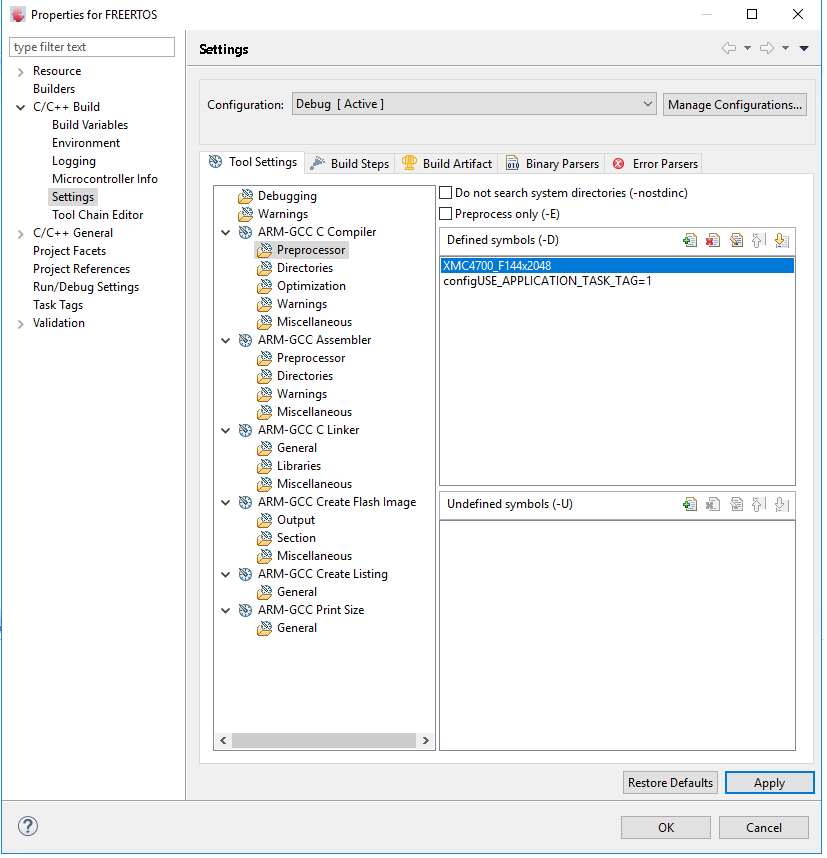

It appears that version 4.1.8 has bit of an omission.
I would like to use Task Tags.
Ideal for use with the DACs on a XMC4000. Can "see" with a scope what task is active.
But this version seems to default "configUSE_APPLICATION_TASK_TAG" to 0
I have a "work around" but I lose it every time I generate code. Very clunky!
Any changes in the future?

As a workaround you could define the macro in the compiler preprocessor options in the project properties.

Thank you Jesus!
That could be a good path.
but ...
I change configUSE_APPLICATION_TASK_TAG to 1 in "FreeRTOS.h" - Good you've got a solution.
But I also change "FreeRTOSConf.h":
- near end of file I add : #define traceTASK_SWITCHED_IN() XMC_DAC_CH_Write((XMC_DAC_t *)(void *)DAC,0,(uint32_t)pxCurrentTCB->pxTaskTag)
- and near top I add : #include
I've tried include "Dave.h", but I suspect a circular reference as Dave.h probably eventually includes FreeRTOSConf.h
Any recommend path to take?

The trace macros are more challenging...
You can try by copying the attached file, after changing the extension from .txt to .tmpl, to your project under Dave/Model/APPS/FREERTOS/v4_1_8/Templates
The file includes at the end a file "FreeRTOSConfigUser.h" if the the macro FREERTOS_INCLUDE_USER_CONFIG_H is defined.
You can use the FreeRTOSConfigUser.h to define the FreeRTOS trace macros, https://www.freertos.org/rtos-trace-macros.html
Regarding taskYIELD_FROM_ISR, it has been renamed to portYIELD_FROM_ISR. See https://sourceforge.net/p/freertos/bugs/198/

Hi Jesus,
Thank you.
Is portYield... the official rename? The online FreeRTOS still refers to taskYield... he sourceforge items wasn't clear.
And the User config does work. Thanks again
