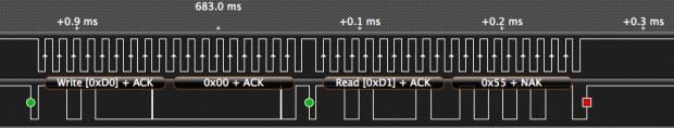

I've also tried to work with SPI and I2C, I use the DAVA Apps for this. SPI works, but with I2C I couldn't receive messages. I've maid a testboard with a DS1307 "real time clock chip" with I2C.
I can write data to it. But I couldn't received data. I've connect a logic analyzer to it. And then i see the received message, so the DS1307 sends a message to the micro-controller. But I couldn't find the message in my program. I also used the NVIC002 App for the interrupt.
What do I mis? I use p0.11 and p0.5.
A screenshot of the logic analyzer.

I2C now also works. I forgot to assign the signal connection by I2C.
