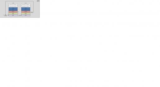

I'm using a DMA002 app and would like to set up "ping pong" buffers, where the DMA002 would point to alternating buffers for DMA transfers.
I'm using the DMA002_GetChannelTransferParams() and DMA002_SetChannelTransferParams() to adjust the DstAddress during runtime but it doesn't seem to be affecting the destination address. DMA002_SetChannelTransferParams() always returns DMA_EBUSY, doing a spin-loop waiting on the status to -not- be DMA_EBUSY seems to indicate that this flag never goes off, and there doesn't seem to be a way to stop the DMA002 app via API (i.e. no DMA002_StopTransfer()). The DMA002 app continues filling "buffer A" like it always has, while "buffer B" is never used.
To clarify, the DMA002 app has been working very well so far with a single buffer. The issue isn't with getting the DMA002 app running, it's with changing any of the parameters during runtime. The comments in DMA002.h seem to indicate that "runtime" configuration is possible.

Hi JoeShidle,
It is not possible to change the DMA channel parameters when the channel is enabled.
In your case the solution would be to use linked lists. Two linked list items, LLI, need to be defined in system memory. The LLIs are linked to one another using the LLP field of the LLI structure. A circular reference is created.
The destination address of LLI(1) is bufferA and the destination address of LLI(2) is bufferB.
If the block size is configured as 1024, the DMA will start transfering 1024 data items to bufferA, and then switch to bufferB. Once finished with the second transaction the whole process starts again using buffer A.
Attached you find a project showing this concept.
Let me know if need more assistance.
