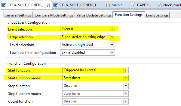

I´ve made an example using DAVE APPs while it was the fastest way but you can make it just with XMCLibs if you prefer. So, two CCU4 slices, namely CCU40_40 and CCU40_41. They have exactly the same values except one has "Timer initial value" set to Timer period value/4 (to get that phase shift). I noticed that code generation for this initial value is wrong while the SetTimerValue function should be called after the clocks are enabled as you noticed too already. However, that´s easy to fix. Another important aspect is to have both timers started synchronously at the same time. For this reason,I added input event for each slice. That looks something like this:
3130.attach
Main function is very simple and it calls just DAVE APP initialization and triggers the start of the timers:

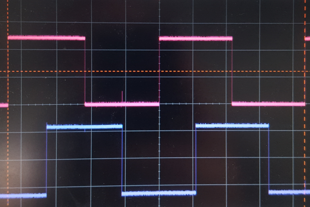

If I place the scope probes on the outputs of the CCU4 slices, I get something like this that seems to be exactly what are you trying to achieve:
3131.attach
