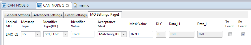

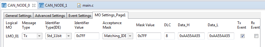

so I will try to answer on all your questions with an example that´ve done to explain data updating and remote transmission request.
I´ve used the XMC4700/XMC4800 board but all the following things can be used by you also on XMC4400 board. I saw that you use CAN_NODE APP, so I´ve made an example using the same APP even though I prefer MULTICAN_CONFIG 🙂

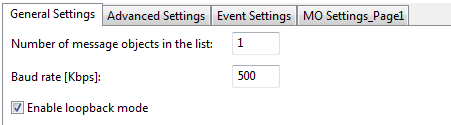

First I´ve initialized two CAN nodes....CAN_NODE_0 and CAN_NODE_1. They are used in LOOPBACK mode. Yes, I´m aware that you want to use normal mode but I would always suggest first to develop an application with LOOPBACK mode while that excludes potential hardware issues from the beginning. When you have an issue and the cause can be a hardware or software one, that´s much more difficult to resolve then to deal only with software ones.
Both nodes have the same "General Settings" tab.Then set the CAN_NODE_0 and CAN_NODE_1 as following:
Pretty straightforward and I guess you´ve already done something like this with the basic example that came with the board. CAN_NODE_0 will be our TX_NODE that will reply on remote transmission request and CAN_NODE_1 will be send the request and receive the requested data (RX_NODE). Notice the data that currently TX_NODE has; 0xAA55AA55 and so on. Later on I will change this data, during the execution of "main" routine. That will answer one of your questions 😉
