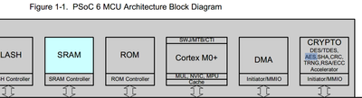

I am looking into speeding up the time it takes for my device to complete a 2-way TLS handshake. A network packet capture is showing that this process takes about 2.5 seconds to complete.
My device uses an STM32F412 MCU + CYW4343W Wi-Fi/BLE chip, and application is built using WICED Studio 6.6.1 with ThreadX/NetX Duo.
I realize that this is a computationally expensive process, so it might just be the way it is. However, I wasn't sure if there were any WICED build/config flags that might help speed this up.
Screenshot of TLS network sniff attached where 192.x.x.x address is the device running code build in WICED.

Hi :
   seems the log matches the sniff log.
Actually, here it depends on the speed of the host computation and the TLS flow.
I will recommend a host with a hardware  Accelerator like the below picture to speed up the process if possible:
======= MBEDTLS - DBG - 15590 msec: [mbedtls_ssl_handshake_client_step()] : [3960] : Write MBEDTLS_SSL_CLIENT_KEY_EXCHANGE
======= MBEDTLS - DBG - 16411 msec: [mbedtls_ssl_handshake_client_step()] : [3964] : Write MBEDTLS_SSL_CLIENT_KEY_EXCHANGE DONE : 0
======= MBEDTLS - DBG - 16423 msec: [mbedtls_ssl_handshake_client_step()] : [3840] : TLS Handshake state : 9
======= MBEDTLS - DBG - 16433 msec: [mbedtls_ssl_handshake_client_step()] : [3970] : Write MBEDTLS_SSL_CERTIFICATE_VERIFY
======= MBEDTLS - DBG - 17832 msec: [mbedtls_ssl_handshake_client_step()] : [3974] : Write MBEDTLS_SSL_CERTIFICATE_VERIFY DONE : 0
======= MBEDTLS - DBG - 17844 msec: [mbedtls_ssl_handshake_client_step()] : [3840] : TLS Handshake state : 10

   we can enable the debug for the mbedtls module.
Actually,  STM32F412 will spend more time than the high-performance chip.
   /* Added for debug purpose */
#define MBEDTLS_DEBUG( X ) //printf(" ======= MBEDTLS - DBG : "); printf X
/* WICED_MBEDTLS End */
I think we can find the exact position where it costs the time.
from the pic the process spends most of the time on:
certificate
client key exchange
certificate verify
That really needs a lot of computation.

So that I am clear on your response, I believe you are saying that there is nothing that can be done in WICED (firmware) to speed up this process with my current hardware (STM32F412 MCU). If I want to speed up this process, I would need to use an MCU that supports crypto hardware acceleration for my specific application. Does this summarize your response?
Zhengbao_Zhang
First comment on KBA 10 questions asked 5 questions asked
sure, thanks for the reply and understanding, the TLS authenticate stage is decided by the mbedTLS flow and host ability, we can't offload it from the firmware side.
