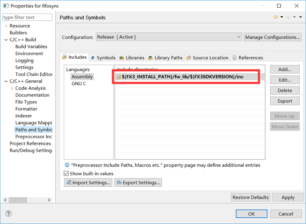

When update sdk to 1.3.4, the img file size became bigger. The fx3 project is the one from AN65974. When compiled by sdk 1.3.4, release version img file size is 132KB.
But when compiled by sdk 1.3.3, the size of img file is 126KB. Because the size of I2C EEPROM implemented on my board is 128KB, so the img file complied by sdk 1.3.4 cann't be burned successfully.  Then why this phenomenon happened? I noticed that the date when the firmware example in AN65974 created is 2015, so the example is definitely based on an old version sdk. Maybe the reason is that the configuration of the example is outdated on the 1.3.4 sdk? If so, how can I gracefully and properly migrate the project to the 1.3.4 version sdk?

I also notice some something of the tool chain settings difference between the project in document AN65974 and default template project of the sdk.
When I directly import the project in AN65974, the tool chain settings and Path settings is as below. The tool chain seems to be "ARM Sourcery Windows ......"
But when I create a project through the template provided by the sdk,  such settings is different, which listed below. The tool chain seems to be "Cross ARM ........."
Then I copied the code from project in AN65974 to the new project directory, so both projects have the exactly same source code. Then the build result of the new project is different. The img file size is only 98kB
So why this two projects which has the same code lead to such a different result? What's the differences between these settings?
Hi Shen,
It seems that cypress has changed the library file path on the latest SDK and i assume they wanted to provided the support for building the older versions SDK projects as well. In your case the IDE refers to wrong path and used wrong libraries, that why the file size got increased.
Its advised to create a new project on the new SDK when you are porting from older SDK to new one. After seeing this significant amount of size difference, the new SDK libraries were well optimized. Have you checked the tested the functionality with the new firmware binary with less size ? Is it working with out any issues ?
