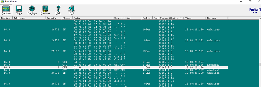

     After a few days of analysis ,I find after upgrade SDK the host sends control command reception time becomes abnormally long,the time will even reach 200ms.However, this time is only less than 10ms under SDK1.3.3. This should be the key to the problem. But I dont know how to solve.Can you give me some help?
     This picture is the time of the command sent under SDK1.3.3:
     This picture is the time of the command sent under SDK1.3.4:
Luca L.

Hello Luca L,
I tested using the UVC application from SDK 1.3.4 and I found the time for SET_CUR request (for brightness control) to be ~712us. Please find the screenshot of the USB trace.

Hello Srinath:
     I have already discovered the cause of the problem. When I handle the SET_CUR command,I sent control commands to other devices through the serial port.I used register mode at the time,Now I am changing to DMA mode, the device is running very well.
     Anyway, I strongly recommend that you test the CyU3PUartTransmitBytes API again. I highly doubt that there is an incomprehensible bug after this API upgrade.Because when I remove this API and replace the CyU3PDmaChannelCommitBuffer, the device response rate is greatly improved.
     If you have test results, please let me know.Thank you.
