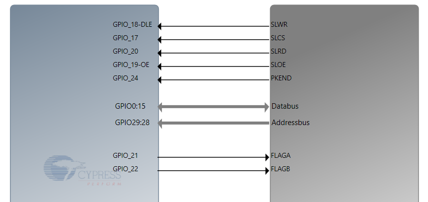

Hello Dineesh,
To receive the data without error you should keep the frequency of the internal clock same as the rate at which data is output from external source.
You can refer to asynchronous slavefifo interface if you need some control signals / flow controls signals.
You can refer to the firmware in the SDK Path: ....\Cypress\EZ-USB FX3 SDK\1.3\firmware\slavefifo_examples\slfifoasync
But for this you need to control the signals from FPGA side. You can refer to the interfacing signals
Note: The bus width is configurable to 8 bits
For timing diagrams of these signals you can refer to application note AN65974
Rashi
