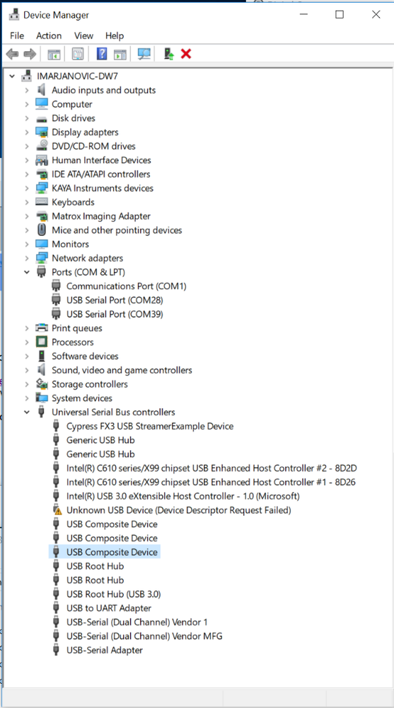

I figured out why the COM ports were not enumerating: when I added the FIFO interface I left its interface number as 0 which conflicted with UART example.  So now the UART virtual COM port enumerates and works as expected.
The slavefifo interface, however, does not enumerate.  The slavefifo example device would enumerate as a "Cypress FX3 USB StreamerExample Device."  How would I expect to see the slavefifo interface in a composite device?
I've attached the modified usb descriptors file.
Yes, you should give the interface number 3 for slavefifo.

I have confirmed that FX3 firmware image works as a slave FIFO or UART but I am not able to access both devices/functions at the same time.
For the following tests the FIFO CY_U3P_USB_INTRFC_DESCR is first in the CY_U3P_USB_CONFIG_DESCR array (see attached USBDescriptors.c file).
  1.  If (PID=0x4B4 VID=0x00F1 && CY_U3P_USB_CONFIG_DESCR.wTotalLength=just FIFO) then
  •   The StreamerExample device shows up in device manager.
  •   The StreamerExample device is enumerated by USBDeviceList(CyConst.DEVICES_CYUSB) my FIFO test passes.
  •   I don’t see the USB to UART device and associated COM port since it is not included in CY_U3P_USB_CONFIG_DESCR.wTotalLength.
  2.  if (PID=0x4B4 VID=0x0008 && CY_U3P_USB_CONFIG_DESCR.wTotalLength=FIFO+UART) then
  •   The USB to UART device and associated COM port appears in device manager.
  •   I am able to open the COM port and my loopback test passes.
  •   The StreamerExample device does not show up in device manger and is not enumerated by USBDeviceList(CyConst.DEVICES_CYUSB).
  3.  if (PID=0x4B4 VID=0x00F1 && CY_U3P_USB_CONFIG_DESCR.wTotalLength=FIFO+UART)
  •   The StreamerExample device does show up in device manager but cannot start (Code 10), invalid parameter was passed to a service or function.
  •   The USB to UART device and associated COM port do not appear in device manager.
  •   The StreamerExample device is not enumerated by USBDeviceList(CyConst.DEVICES_CYUSB).
I’ve attached UsbDescriptors.c and device manager screen shots for tests 2 & 3 above.

By modifying the EZ-USB FX3 SDK\1.3\driver\bin\Win10\x64\cyusb.inf by adding "%VID_04B4&PID_00F1&MI_00.DeviceDesc%=CyUsb3, USB\VID_04B4&PID_00F1&MI_00" I was able to get the StreamerExample from the composite device to to bind to the correct driver.  I then manually bound the USB-UART device to the correct driver by updating the device driver with device manager.
How to bind the CDC USBUART device that comes up under "other devices" to a virtual COM port?

The instructions worked for the most part.
After following the above instructions all the devices showed up as expected in Device Manager but the Control Center app started blowing up when it enumerated the devices and got to the "Cypress FX3 USB StreamerExample Device".  My test app did the same.  To fix it I updated the driver for Cypress FX3 USB StreamerExample Device to C:\Program Files (x86)\Cypress\EZ-USB FX3 SDK\1.3\driver\bin\Win10\x64\cyusb3.inf (why was this necessary?).
Both the USB-UART device and StreamerDevice are now accessible at the same time.
Yes, this is necessary for one time in one PC until you delete the driver for the device.
